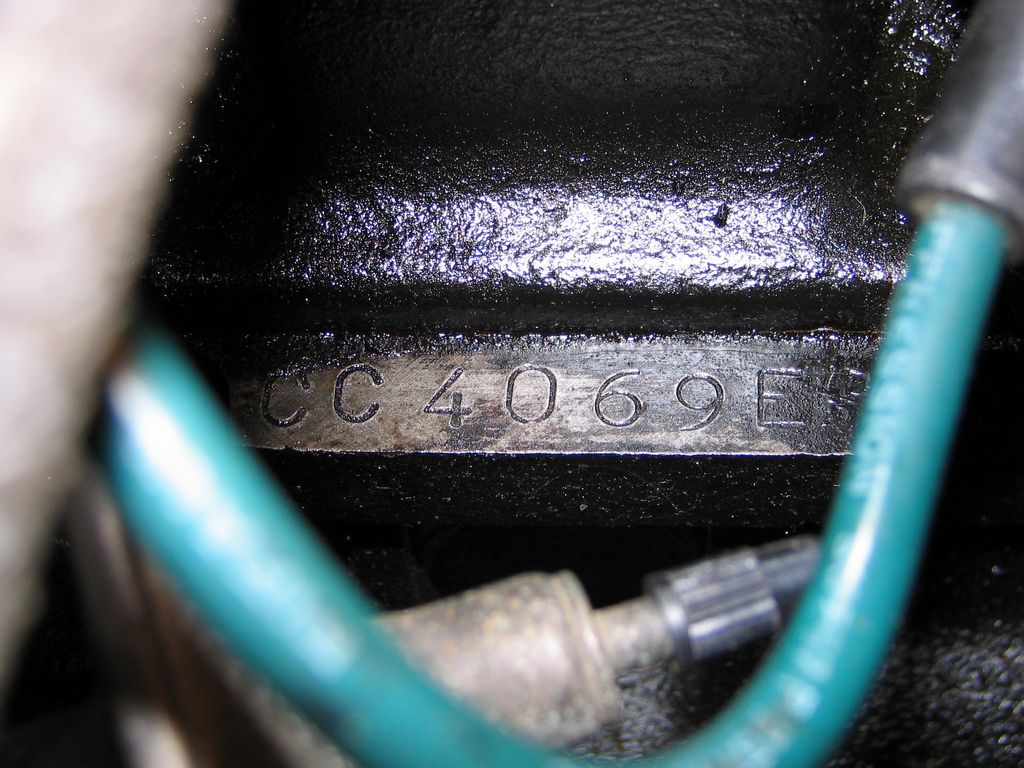

Didn't get around to posting this until. I have a 71 TR6 with engine # CC4069E. I have always believed it to be from a TR250 also. Pretty close number to yours. Pete
