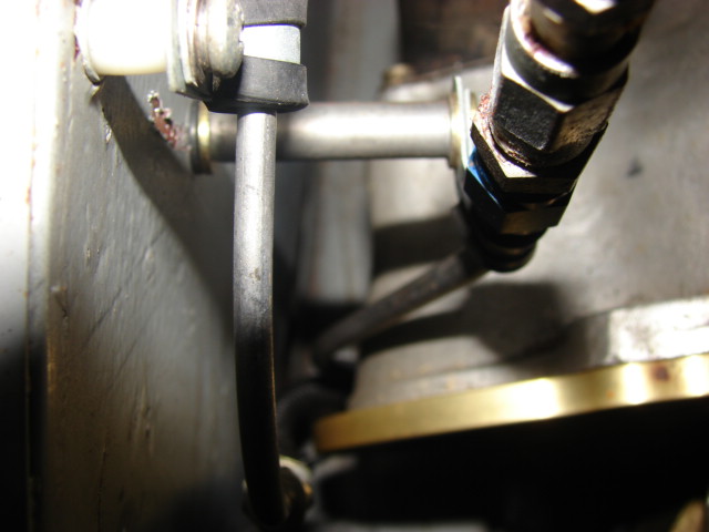

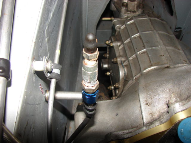

Tony, here's one possible approach.
Jeff
