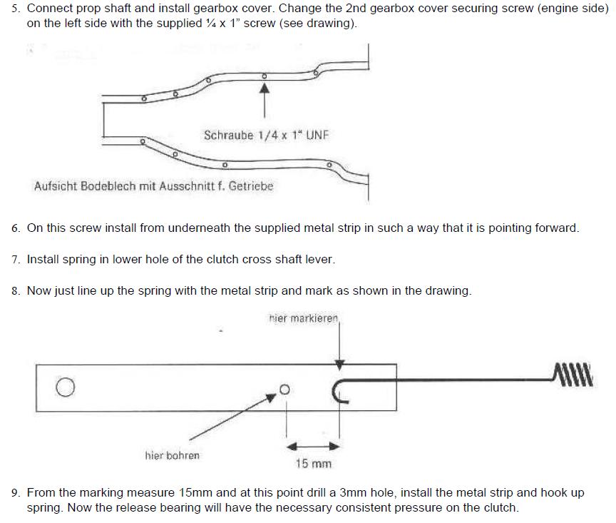

Make sure the return spring is present and accounted for, then set to the factory adjustment of 0.1". I'm running a similar setup in my TR3 (except it's a later TR6 gearbox) and that works for me.
But if you still get the squealing noise, I would probably try going the opposite direction : back off on the adjustment and then install a preload spring. There are several kinds of bearings sold as replacements that do not turn as easily as the stock bearing, and they frequently cause this kind of problem.

Thanks for the diagram, I'll try that tomorrow. Both thust bearing and sleeve were purchased through Moss Europe P/N GRB211 & 147848
