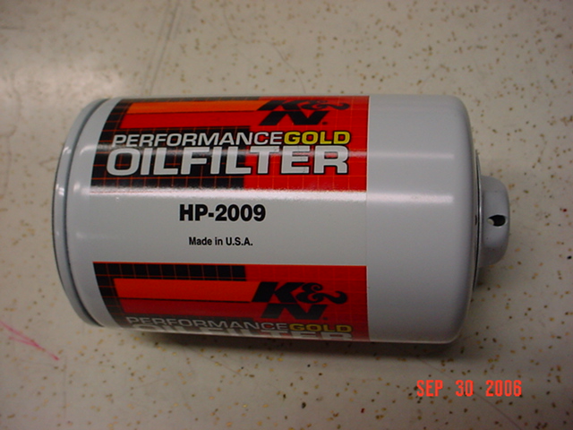

Provided that it is a spin on filter, once you get it off, if you use a K&N filter, it has a nice one inch hex nut on the end. Makes installation & removal very easy. Really beats strap wrenches & jamming screw drivers through the can. In addition, it is a very high quality filter.
Many screw on filter adapters use the K&N HP-2009. A pic is attached.

Just one more good reason to use a K&N filter--it has a 1" nut welded to the end of the case and there is a hole for safety-wiring the filter.
