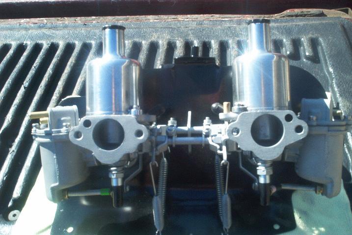

Caution: Put your shades on before viewing :]
Drew, you have some carbs to go with that motor now :smile:

Hap Waldrop
Re: Caution: Put your sahdes on before viewing :]
Tony, see how I set up the return springs, might not be factory, but it works well.
tony barnhill
Great Pumpkin - R.I.P
Saw that, Hap - where do you hook up the choke cable?
Hap Waldrop
That will be Drews job, but on this set, you'll notice the brass tubing on the rear carb (toward the middle), it passes thru there and hooks on to the the choke bellcrank on that carb, when the the choke is pulled the linkage from both carbs will pull the jets down.
