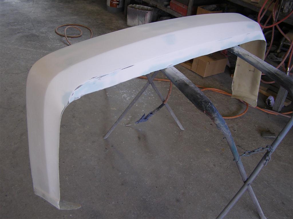

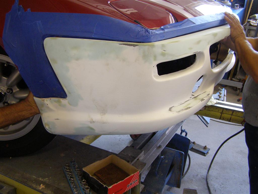

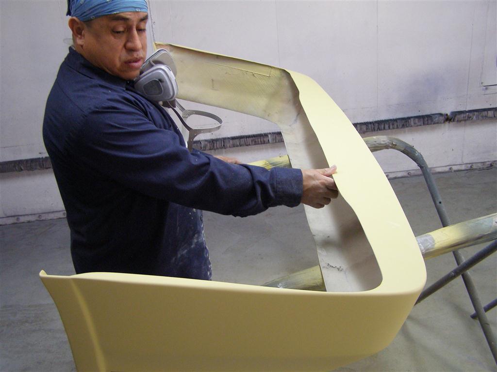

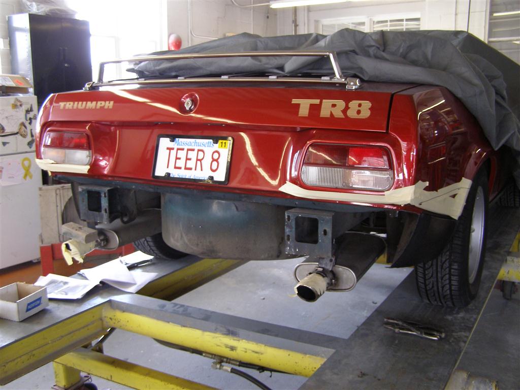

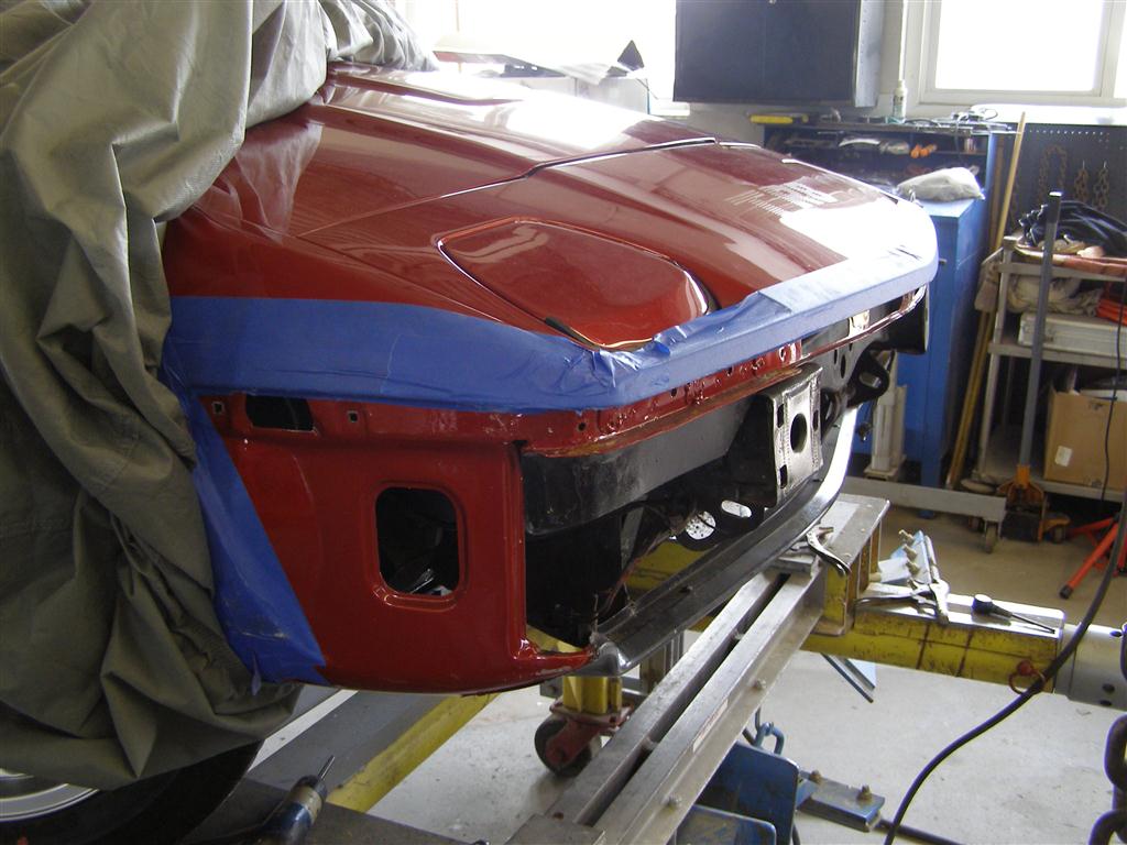

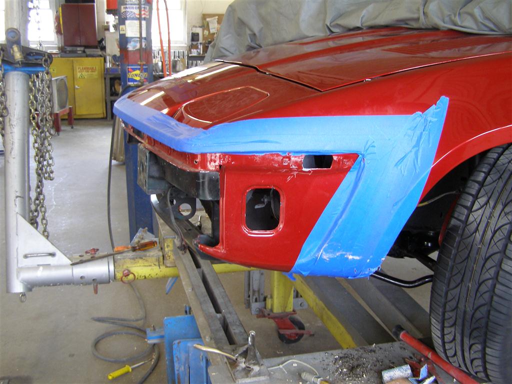

Yesterday began the face lift on the TR8. Literally and figuratively.........
The guys at A&E started with the rear and are tweaking it in, little by little. They have to cut the rear inner support ends off and then the tight fitting will begin, after the inner is remounted and used as a support.
More to follow on the front end next week. For now Jorge is reworking the fiberglass to make sure it is smooth and has no waves in it.

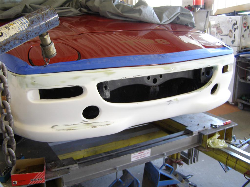

They are getting closer Don. The ends are cut off of the rear bumper support and it's back on the car. They are making a spacer to run along the top to shift the bumper up an inch and they are making a black rubber seal to run along the edge of the new rear bumper between the it and the rear panel. That will finish any slight gap off nicely. Once that is ready for paint, they will start fitting the new parking and fog lamps to the front panel before fitting it to the car.

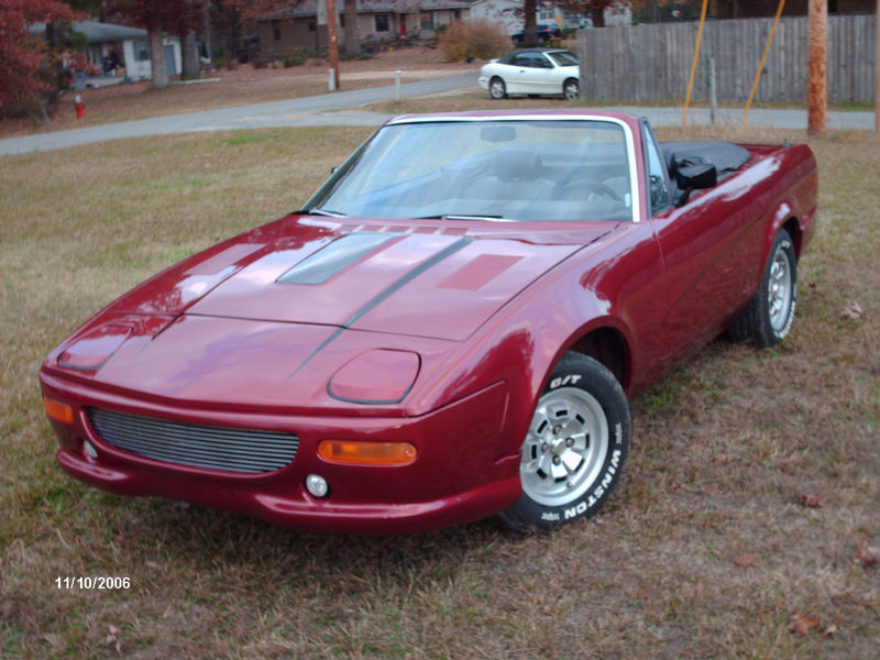

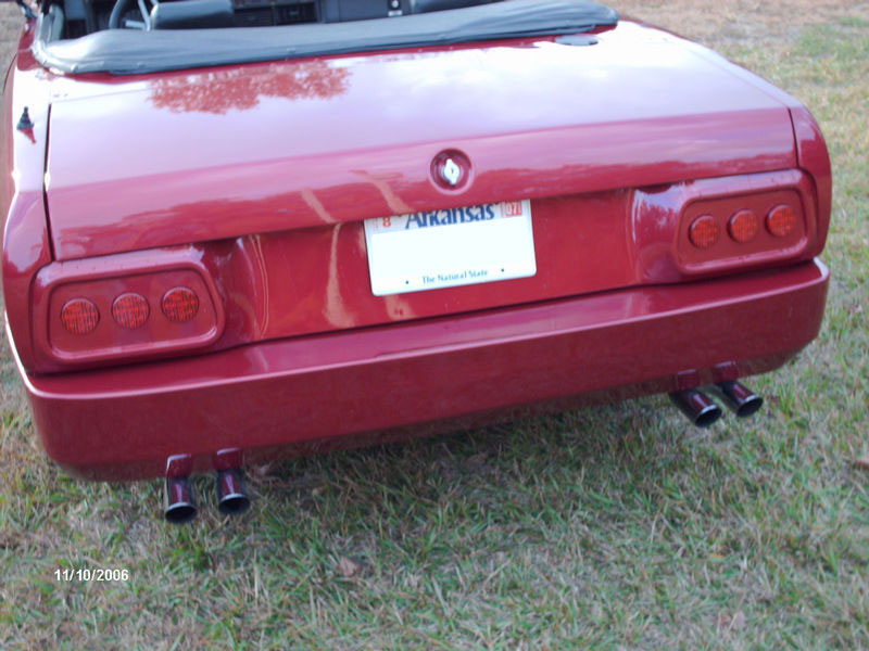

Here are a few pictures of what it should look like, but with stock tail lamps in the rear and a black mesh grille up front and no black paint on the hood.

I've heard Aston Martin and French, so Italian is new to the mix. Being Italian, that doesn't bother me at all.
I just hated those big add on rubber bumpers and painting them didn't take the "big" factor away.

I agree, looks Italian. Almost Ferrarish very smuggly with it's eyes shut. Mondial maybe? I'd sport it. Now this has gotten my thinking...
Interior is too mordern for me.

Sorry,but those pictures just don't do it for me.
I thought that it looked great the way it was.Just my opinion.

That's OK Doug. These type of modifications always cause a certain amount of differences in opinions. As is evident with my TR6, I usually do what I think I like the most, as everyone usually does with their own cars. I just posted this to show what is out there, still available for these cars.

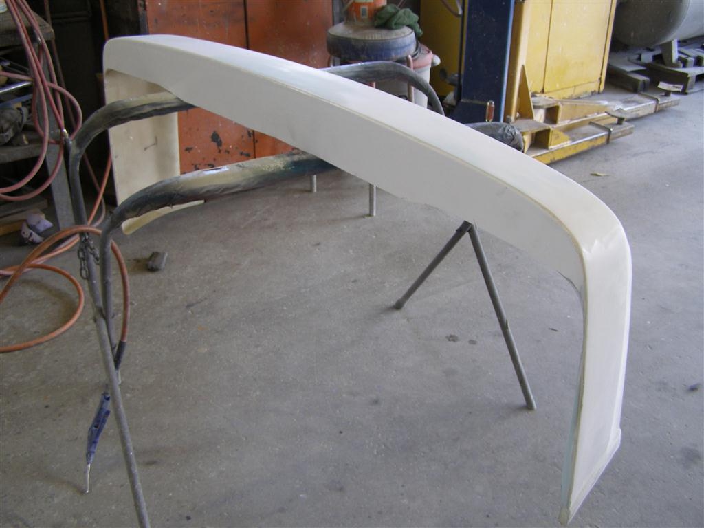

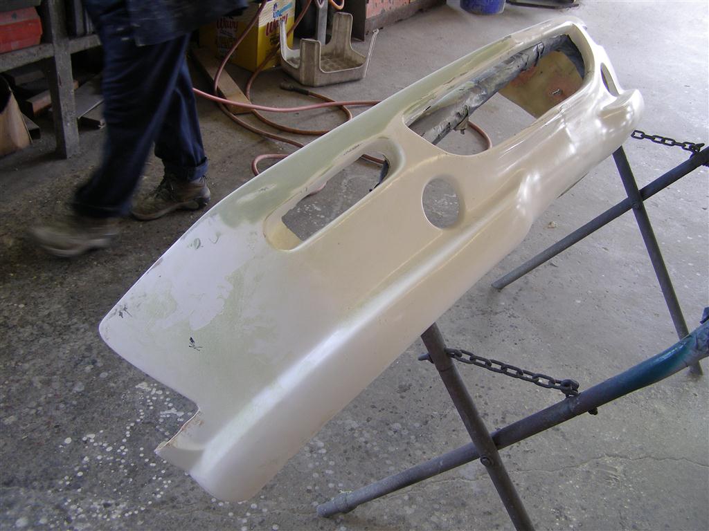

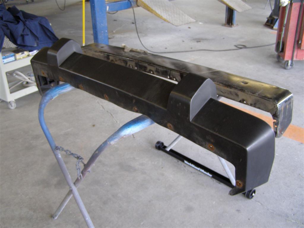

Yes Don, that could be considered one of my "eclectic" projects.
But these will show the progress along the way up until noon today.
