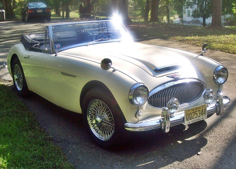

Hi Goldie,
I'm with Bob as well as Dave's perspectives but believe this has been long put to discussion and for most, to bed ... even though I still have my Lucas mirrors mounted above the axels. When first purchasing my Healey, it was common to install Lucas mirrors over the axels as it was thought they would provide a full view at the sides of the car. The problem was that you needed to be far sighted to get any benefit and needed a willing partner to adjust them when needed. Since I was more near sighted, they were stylish but useless to me and usually ignored. With age, my sight moved toward far sightedness and the mirrors finally provided some benefit. However, as usual, cataract surgery resulted in my being moderately nearer sighted and again the mirrors became useless.
So, are my experiences unique? I don't think so and advantageous positioning of a mirror on or close to the door where it can be easily adjusted and USED would seem a no-brainer for those considering placement. The best placement for the mirrors would be where you can easily see without contortions that also allows you to see beyond obstacles such as side and windshield frames. In this case, I suggest that proper placement must take in to consideration driver stature and position when driving. In short, it will depend upon placing the mirrors where you see best.
However, all that being said, I will stick with my original fender mirrors and, since my Healey is far from being my daily driver, will trust in my carefully observant and listening driving to keep me aware and protect me.

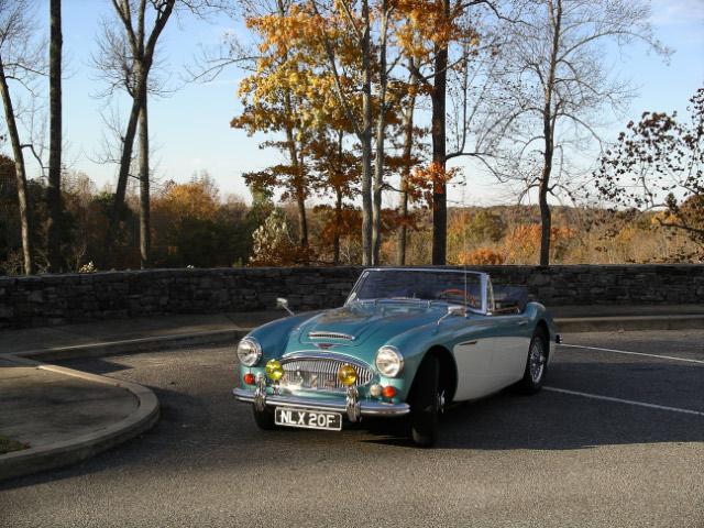

The only place to put these mirrors is as pictured below:
I'm with Michael on this one��
Keith_M
Mine are where Michael's are, but I freely admit that my placement was determined primarily by looks. I do use them, but they are a pain to adjust. If you decide to put them out on the fenders, I would recommend drilling holes for the mirrors and welding a captive nut on the underside. The screws just don't seem that strong to me, and it's easy to bump the mirrors as you work on the car. Using a machine screw and a captive nut is much stronger.
