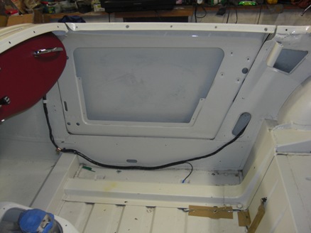

Me again. Does anyone have a picture, or can you describe the pathway the wiring harness takes from the tail lights to the main harness on the passenger side? Any help is always appreciated.

The wiring has clips on the back bulkhead in the cave, threads to the right side and behind the sheetmetal facework, out the hole to the rear the door, along the bottom of the door and up to the connection at the top. The wire harness is covered by the side panels under the door and on the outside pass. sidepanel.

But this is what I did, by drilling new holes and fishing the harness. I did not like the bulk of the harness behind the panels.
