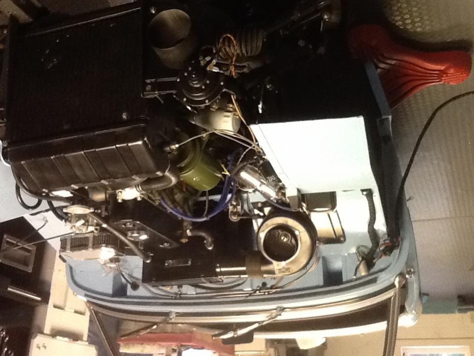

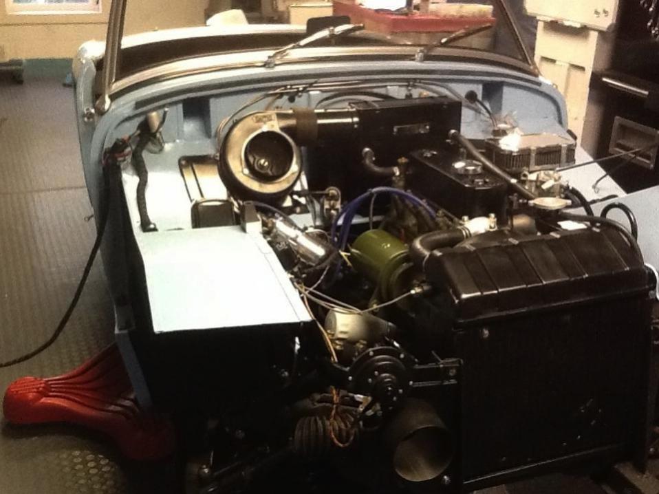

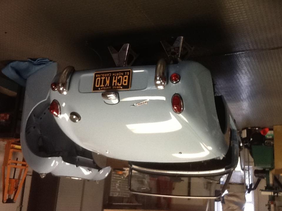

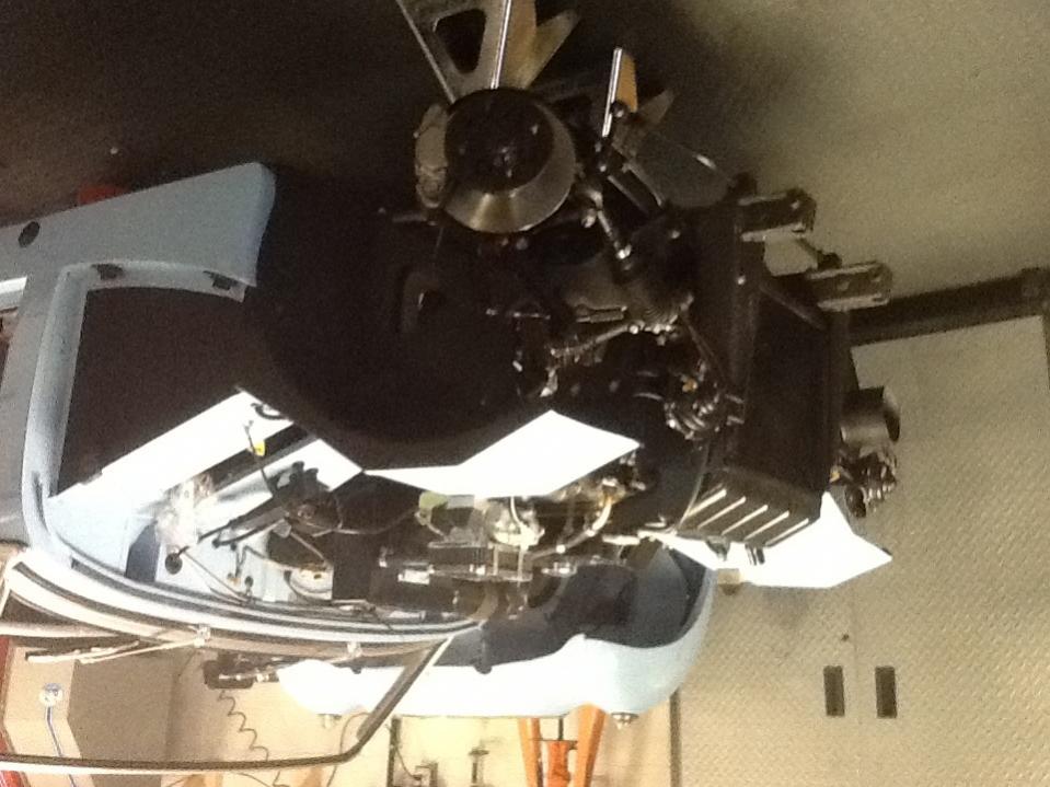

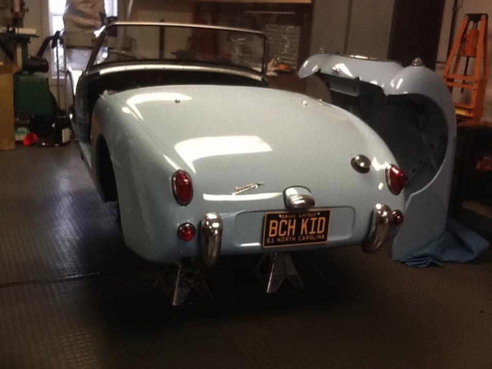

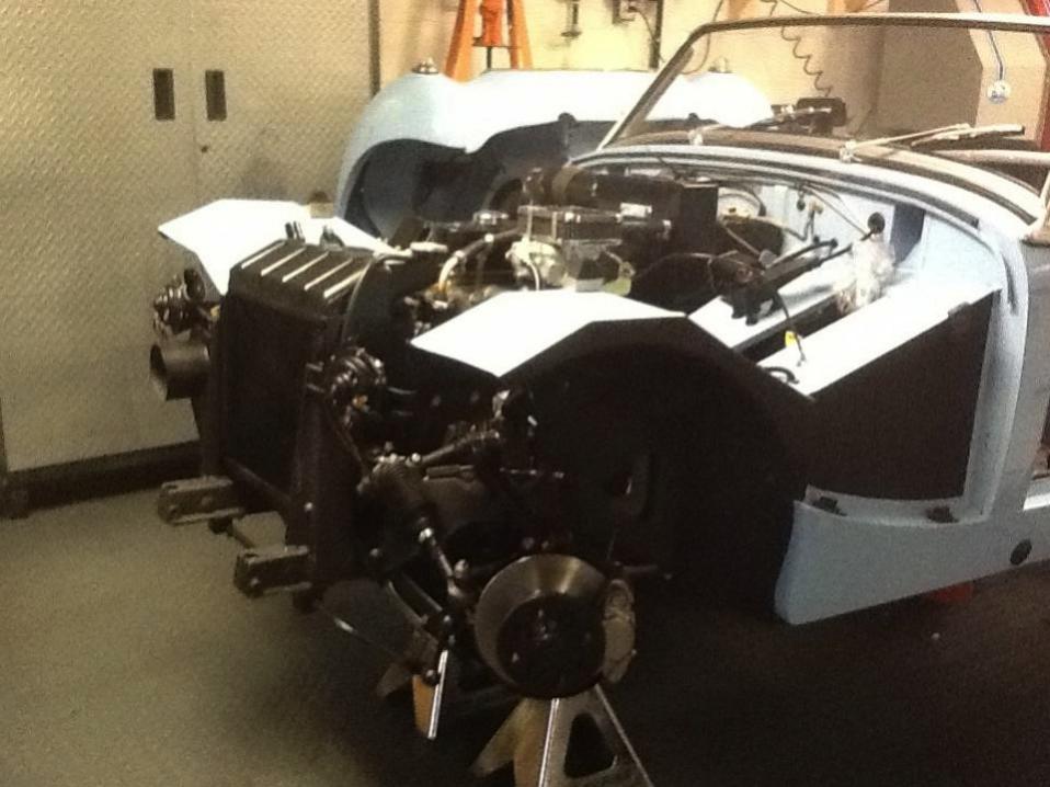

Just so folks know that there really is a car at the other end of all my requests for help I have included some pics.
Have no idea how the pics ended uo upsidedown. I tried twice...oh well

Reposted your pix for you. - the car's lookin' great BTW!
