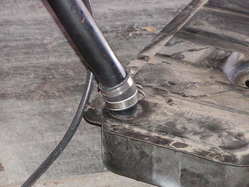

I had to modify my filler tube to get the clearance I needed as the tank was a questionable quality repop. Filler tube extended 1.5 inch into the tank. Recovered that volume also with a Dremel and cut off wheel.
E
erstearns
Never would have thought about cutting and extending the filler tube...should have been an obvious solution when you look at parts diagram.
What does the top end through the body look like? I assume just enough through to get the cap on with the body grommet installed with the lip up?
Thanks, Eric
leecreek
Completely adjustable and does not bind in the hole. Install tank, then gasket with a little dish soap then the filler tube. Adjust to your requirements.
