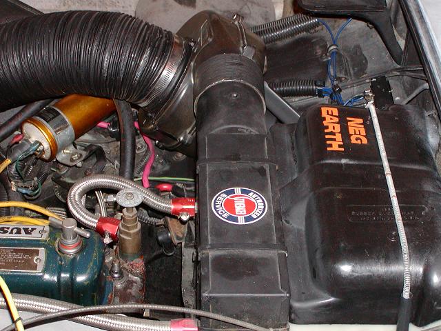

leecreek
Re: Bugeye-better to have negative or positive gro
My label when I converted to a alternator.
