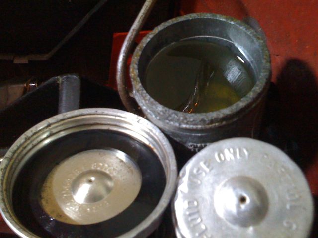

doughairfield
doughairfield
Thanks for the suggestions, I'll check for that bump in the underside of the cap tonight, I don't recall seeing it last time I had the cap off. And I'll clean the rim of the cylinder off and make sure it's nice and smooth.
I fill my reservoir to that line around the inside of the cylinder, just like Jay's picture in his post so I feel like my fluid level is good.
doughairfield
doughairfield
Hopefully this pic is not too grainy.
It looks like that bump is present on both sides of my cap, so that part looks good. It looks like on closer inspection that the fluid is leaking out from under the cap on the front side of the master cylinder.
I cleaned the rim of the master cylinder up as much as possible but it looks like time as not been kind and there is some significant pitting on the rim and the threads and the threads are a bit worn. It also looks like there aren't any threads as they come around the front of the cylinder either.
I'm gonna try putting the cap on without screwing it down to tight and see how that goes if no one has any suggestions from the pic.

TR3driver
Great Pumpkin - R.I.P
The missing threads probably mean you are stuck sourcing another MC.
However, yours might be repairable. Drain & remove it from the car, then stuff a rag or paper towel tightly into the bottom (to keep the swarf away from the hole).
Then use a flat file to touch up the lip of the reservoir. Work the file at different angles, but always supported by both sides, and you should be able to get a clean, flat surface.
Now paint the top edge with machinist's blue or a black magic marker, and install the cap without the rubber seal. Look for the high spots where the cap hits the lip, then file those off (again trying to hold it as flat as possible). You won't get it perfect, but it shouldn't be too hard to get close enough that the seal can take up the difference.
