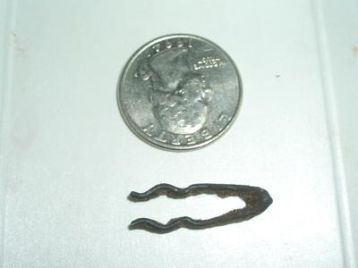

When I bought my car, they had little pieces all over the inside of the car. Just to be sure, would this be what you were talking about? This looks like it would work underneath the radiator, and the ones along the bottom of the body would be one of those posted earlier.
Whitephrog
Exactly!! You need seven of those, five for the brake line and two for the fuel line. You also need three clips like the photo John-Peter posted for the fuel line as well.
