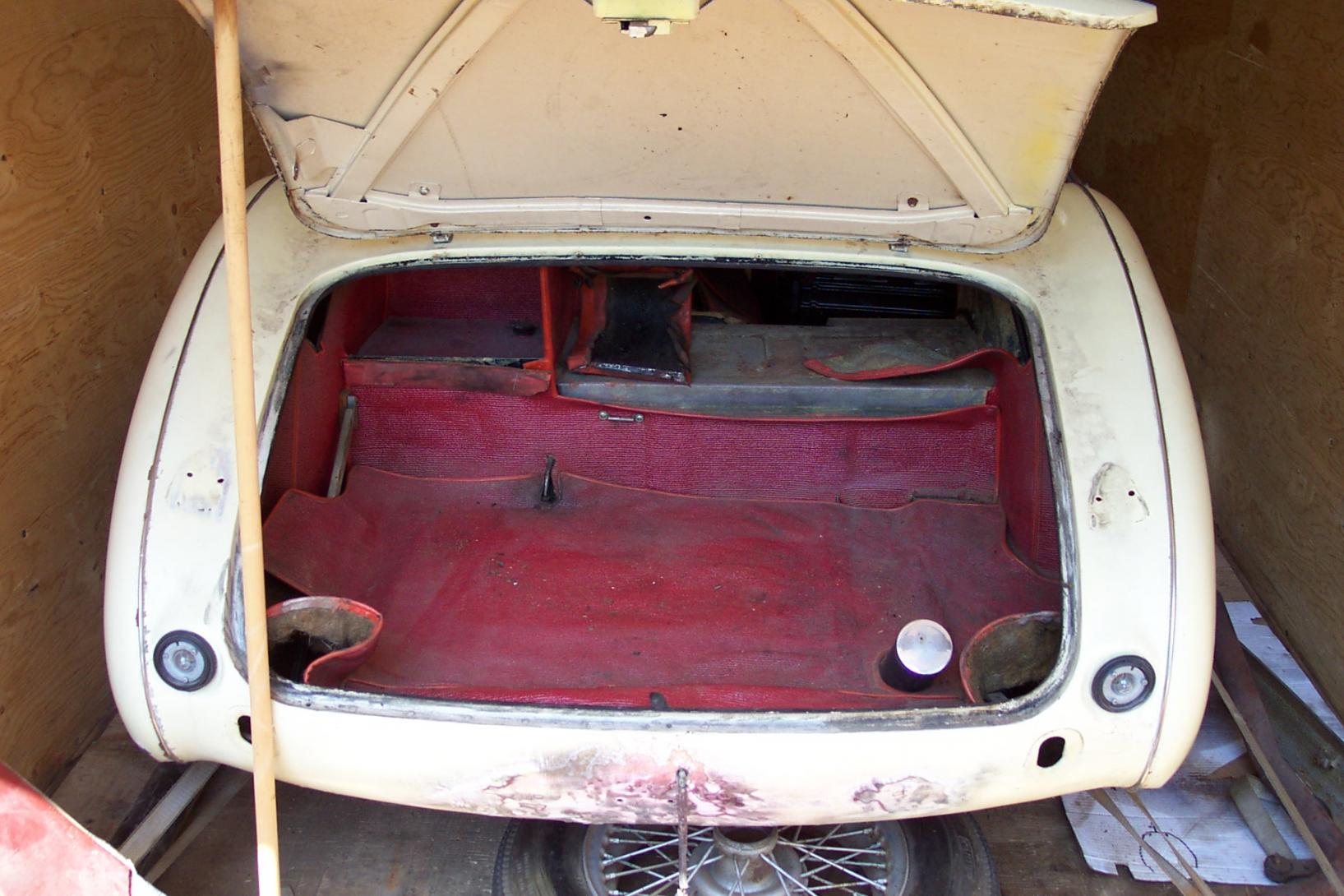

abarth69
I have one of these cars waiting in the wings to be restored Cheers Mark

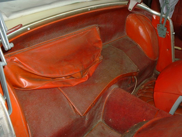

abarth69
Old English white but someone has done some touch up with different color pretty sure is its 1954. Yes you have to get the materials custom dyed. We should be able to use most of the old material when we get her back on the road
