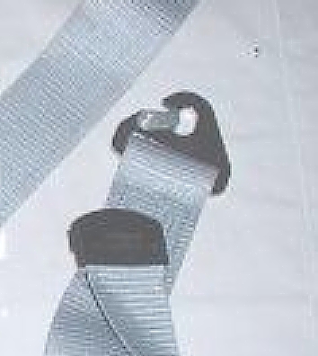

Then you have the 1960's style of spring-bracket called "Sister-Hook" which attaches to a floor-mounted eye-bolt, same as in aircraft today, in fact that was how belts were invented. Both American and European cars used that style in the 1960's. In the mid 1970's they all went to bolt-through-the-floor permanent attachments. I like the spring brackets because they are quickly removable if needed, but will not fail in an accident.

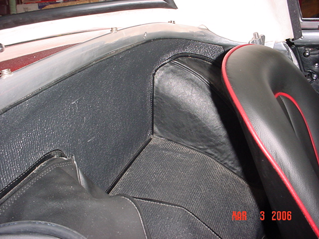

A BN1 is an Austin-Healey that is a year older than the BN2 in my sig pic. Attached is a pic of my interior with the soft top removed. When folded, the soft top pretty much fills the space behind the seats.
D

We are kind of hosed when it comes to shoulder harnesses in the Healeys. Ideally we want to have the anchor point to be within 30 degrees (higher) than horizontal at shoulder height. As we know, there is no structure for this type of installation. If we had ridgid, non-folding seats that could withstand high G loading we could attach the belt to the floor directly behind and at the base of the seat. As we know our seats are anything but capable of high G loading and the back doesn't even lock in place. It seems to me that if you fastened a shoulder harness anywhere on the floor you would risk high compressive loads in a frontal crash. My only solution would be to have a roll bar , preferably with a head rest pad and a good solid attach point for the shoulder harness. This all leads to what we all know. A bad accident in any big Healey is not going to be pretty. I almost hate to ask, but does anyone have any experience, or know of any accidents that were more than fender benders? I am installing vintage style military seatbelts in mine (they are from a UH-1 helicopter, and they have been quite comfortable when I've used them), and I've come upith no other way to utilize the shoulder harness that goes with the belts. I've yet to go the roll bar route. I think I'm going to have to make my own and I'm going to do my best to make it look like it belongs (when I get to it). In general all I expect from my belts is to keep me from being ejected (which might actually be preferable to that long solid steering column).

My first car was a 1969 MG-B Roadster or "MK-II" as the brochure said. It came with 3-point seat belts. The third attachment point, (the shoulder strap end bracket), extended behind the seats and attached to the rear body horizontal panel right in front of the convertible top or toneau cover "snaps", or whatever you call them, those little chrome "towers" onto which the bottom of the top snaps onto?? The belt's end bracket was attached by a very large, nicely rounded chromed bolt, probably 19mm socket, which sandwiched the belt's bracket between the body and some other chrome spacers. Maybe copying that 1969 MG-B mounting would be a way to upgrade your car and have 3-point belts assuming the Healey has any space in front of the top's rear. But even if not, nothing is impossible. There are special brackets and hardware available to achieve any impossible installation in any car. Like the song said: "Do what you like..." Attached is a pic of the "sister hook" brackets used in cars from 1965 through 1975, which were adapted from aircraft belts.
