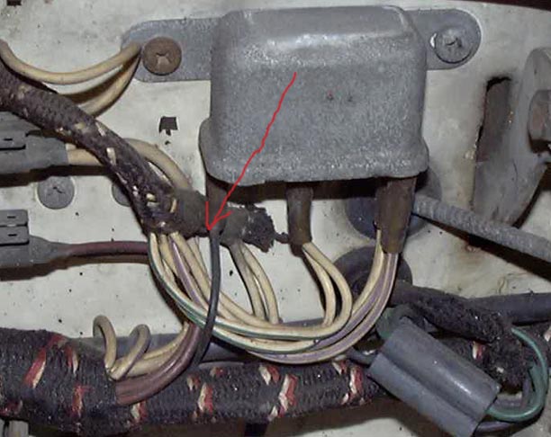

Hey all,
Almost got the replacement wiring harness installed -
thanks Randy and Keoke - but quick question.
On the main trunk on the left side of the firewall area
by the fuse block, I hooked up everything as original
to the fuse block and I have an extra black wire with the
push on type lead - not a bullet connector. <span style="font-weight: bold">Thinking</span> it goes
to the fuse block but did not take one off like it so anyone
have suggestions ?
Thanks,
Mike
TimK
Black wires are ground wires -- It can't go to the fuse block.

More than likely, that goes to your overdrive relay. I'm sure your layout is a little different, but here's a photo.

Thanks y'all,
GregW's picture is worth a thousand words as there is an unused post on
the OD relay.
Mike
