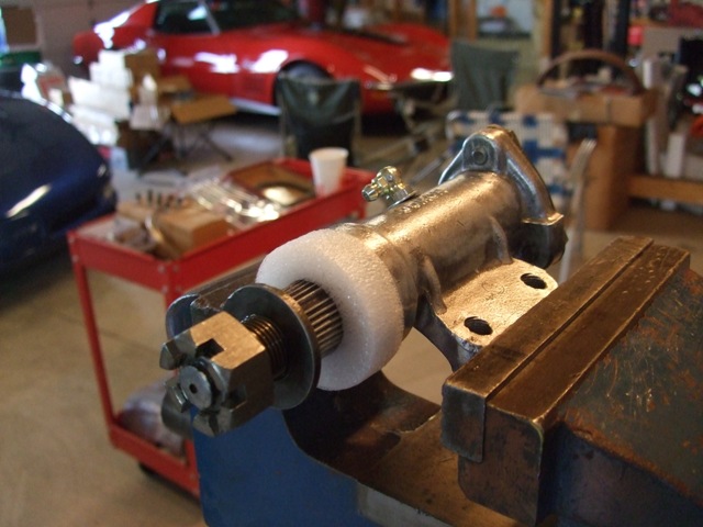

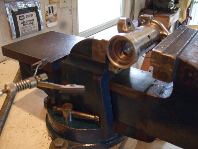

I think we might be mixing up the terms about the steering box and the idler box. The idler box idler box is fastened to the chasis on the opposite side of the steering box to carry the steering arms. If you are checking your idler box you are not going to drop a screw driver very far down inside of it. The idler shaft is a solid shaft which fills the complete void of the idler box. The top end of the idler shaft is just below the top cover of the box itself and there is no room for very much oil or anything else in there. The idler shaft is held in position by bronze bushings. The bronze bushings have grooves cut into their bearing surfaces to allow what little oil you can get in there to weep down along the shaft. The shaft and bushings have to be a very snug fit otherwise the shaft would be loose in the idler box and the steering would be loose. When you install new bushing you have to hone them to fit the shaft that's how snug the fit is. If you try to push grease of anykind, whether it is pentrite steering box lube or a 00 corn grease or etc it will not get very far down the idler shaft because of the snug fit and the very small void at the top. Realize that you also need the top plate to fit the top of the shaft snuggly to keep the shaft from moving up and down in the box. So there is no void to speak of. The ideal lubricant would be a 90 w oil. This is because it will just saturate along the bushings and keep the shaft and bushing lubricated as long as it last. But truth is it leaks out. That is why some of us have come to the conclusion to install a zerk fitting in the body of the idler box. The only small void along the shaft of the shaft is a distance between the bushings where the diameter of the shaft is smaller that the ID of the boring in the box by the thickness of the bushings. That's the only place you can put a zerk fitting because anywhere else and the inside end of the zerk fitting will scrap against the shaft. You will see in my one pic that I have installed a small washer under the zerk fitting. This is to shim it out a wee bit to keep it from scraping the shaft. You can pour 90 weight oil into the top of the idler box and hope that it will weep down to the bottom bushing, but good luck. I have elected to put in the zerk fitting and just grease it every spring. I have put the Pentrite steering box lube into a small dedicated grease gun and I inject it into the center of the idler box every year. See pics:
vette
Adjusting the idler vertical play is done with gaskets under the cap, known as "joint washers". The Bentley manual, section K.5 states:
Your right Steve. And it is because of those joint washers that you can not inject much oil let alone grease into the top of the idle box.
steveg
yup - that's why I slathered my shaft when I had it apart. Next time, I'll install a zerk like you've done.
