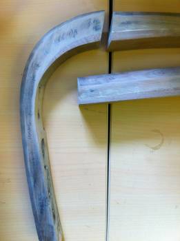

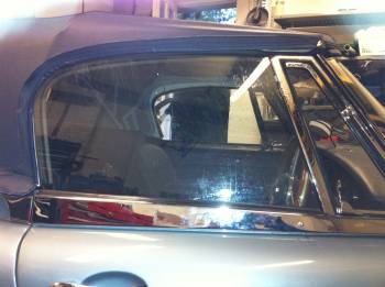

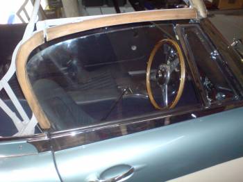

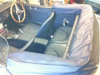

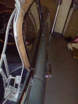

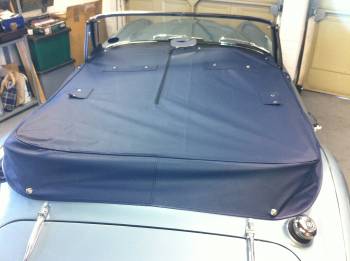

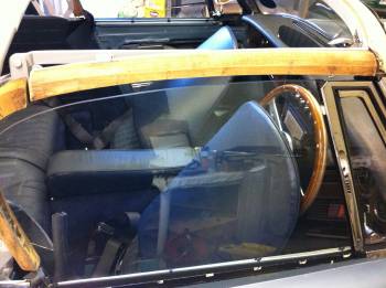

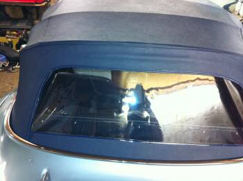

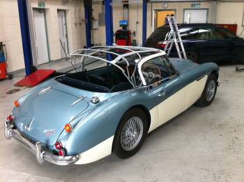

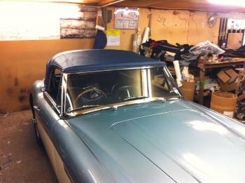

I can honestly say that the biggest and hardest job has not been an engine rebuild and fit into newly painted panels on engine bay, rear axle refit, windscreen rebuild or trimming the carpet, but instead I have spent over a year trying to get the hood (top to you over the pond).
I initially thought it was a couple of day job, but then you find out the gap is too big above the windows, too big to seal against the rubber seal, and the rear of the window hits the rear cant rail.
Well with their help I have spent a year, shimming the hood frame, elongating the fixing holes, adjusting the windscreen / quarter lights / windows etc till I got it some where near and then modified the cant rails to suit.
I then ended up with a nice 5mm gap around the window, a nice tight seal, and after leaving the final hood trim to a proffessional (one of the few jobs I didnt do) I picked it up Thursday in the rain, and travelled 70 miles home at 75mph with not a drop of water!
A few pics of the issues and end (only thing need fitting are the end caps / and bottom foam before someone notices (Rich),
thanks again to both

Beautiful job Andy ! I've installed 3 BJ8 tops over the years and hated every one of them. Really hard to get a good fit and you have what looks to be perfect !!
Well done,
Mike
Congratulations Andy!
As Mike mentioned, doing it yourself is a lot of work, not to mention the frustrating learning curve. (Ask me how I know this.) The reward for all your time and effort is a nice fitting top, that you can take pride in knowing you're one of the few who tackled this project. (Others who don't even try, well they're smarter than us who do...kidding, but really, am I...lol.)
So, you're now our go to guy with top questions! (Did I just throw you under the bus...lol ). Beautiful job Andy!
