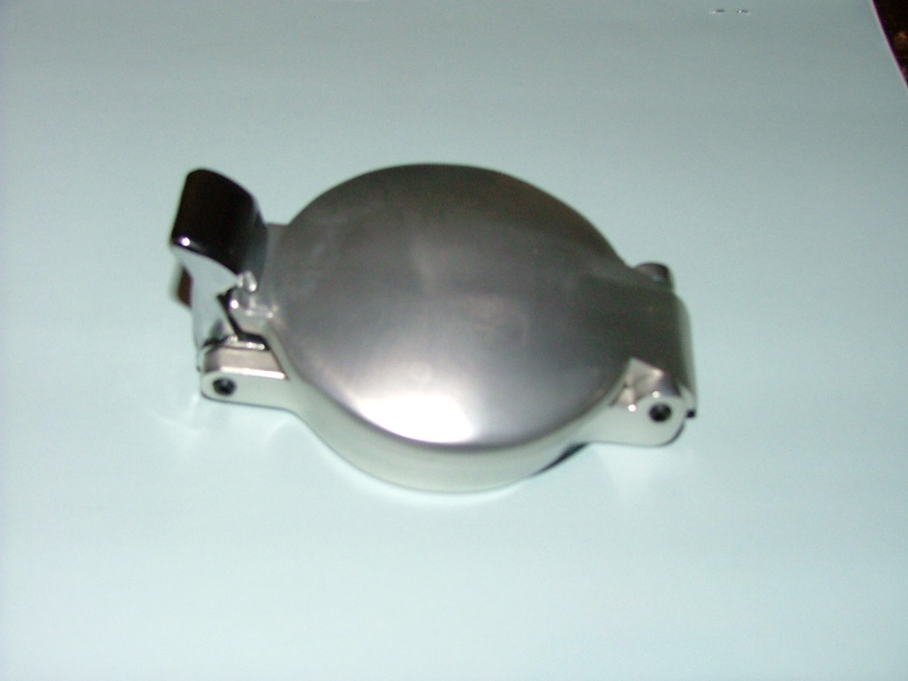

Now have some Aston fuel caps made by mocal and brass adapters available for sale
Send me a email for more details
Adamb

I bought my mocal Aston cap from Adam and couldn't be happier with it or the service I received.
But I have two questions. First, which way should the cap be oriented when installed. Second, the collar fits over the original opening, but needs a means to adhere it to the pipe. The recommended methods are solder, weld or epoxy. I would like to make sure it holds well, but would also like to be able to remove it if necessary someday. Any ideas what the best method would be? Thanks.
adamb
Member
Re: BJ8 Flip top gas cap conversion caution
Had a word with a few restorers and they say the best way is to get it soldered on
Hope this helps
Adam
SHG
Thanks Adam. Did they say anything about which direction the flip should go? Once I install this top, it's not going anywhere so I really want to make sure I get it right the first time.
