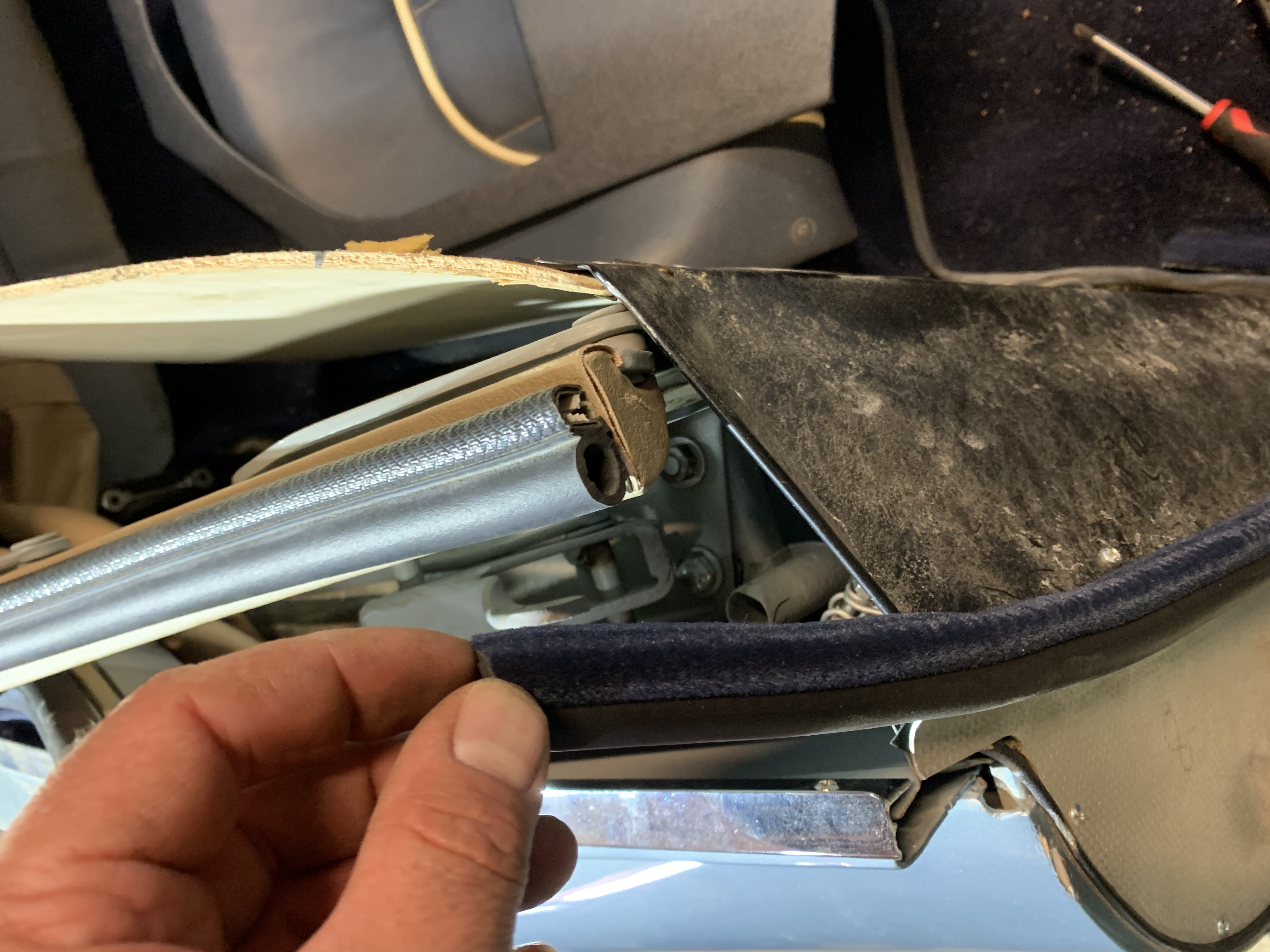

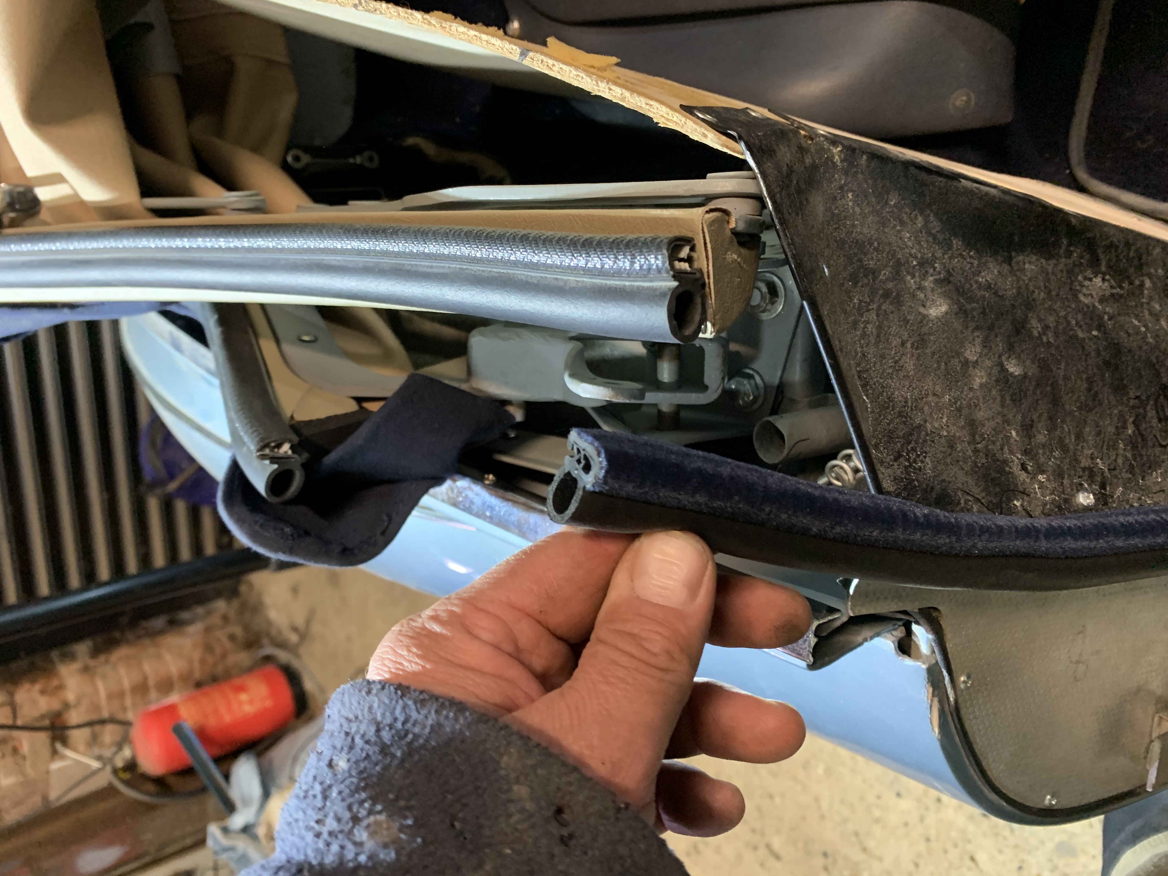

Hi All, i'm confused as to where the door seal on my BJ7 ends, should it bend 90 degrees and go along the top of the rear quarter panel 4" as it states in the book ?
So if im right it would just bend over and clip on the top of the metal part on the rear quarter panel (once trimmed)
Rob

I took mine over onto the quarter panel and used that clip on the end, no Photos as have taken it all apart again to sort out the boot.
The BJ7 s that I have seen have the same detail.
:cheers:
Bob

Hi Bob, many thanks, i will run with that then, just seemed a bit odd to bend the seal 90 degrees.
Rob
