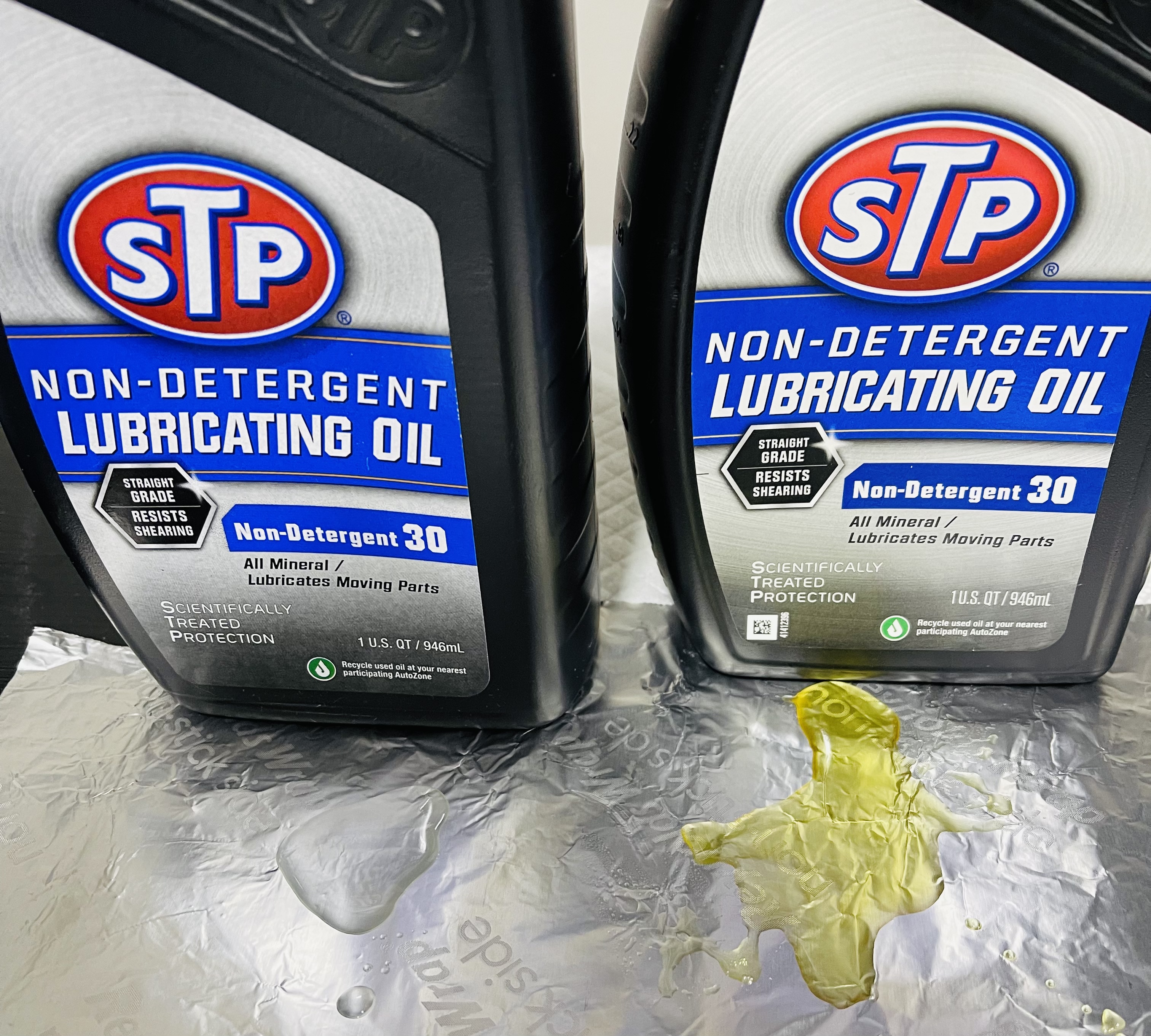

Resurrecting an old thread because I had a very odd experience today. I elected to use 30W non detergent oil in my ovedrive today, countess threads on it but John from Quantum and Mark Macy both recommend it so good enough for me.
Bought 2 quarts of STP brand from Autozone. Drained the old oil, cleaned everything up and started to pour the first quart in. It was coming out kinda transparent in color, like 30w oil but water color. Ok, well I’m not familiar with it I think I used Redline before so I thought, “ok odd but I guess it is what is is”. Then I opened the 2nd quart and started pouring, it was amber yellow. Same package 2 very different colors.
Thoughts? I’ve contacted STP through their website but no reply yet. Should I drain and start again or move on & don’t worry about it?

I did the same...but the drum kept sticking. Went with the favorite, MT90 and have had no problems. MT90 is the undesputed favorite for OD tranny's!
charlie74
Agreed. I tried the 30 WT oil in my O/D gearbox and ditched it after a couple of drives when I found I could not shift into 1st when hot or cold. I switched back to MT90 and have had no problems since…
DavidApp
Was the container sealed? Someone may have filled it with water and then returned it for a refund.
Just a thought.
I would drain it and go with Red Line MT90
David
luke44
Definitely sealed I’ve still got the seal remnants from both bottles.
Dang I hate having to do 2 oil changes but I just don’t think I can risk it. I think I went back and forth on this before and decided on MT90 8-10 years ago. Oh well, car is still on the stands at least that’s a good thing. Can’t say I’m impressed with STP’s QC standards.
luke44
Interesting reply from STP. Sounds like buck passing to me. I highly doubt Autozone said “color doesn’t matter, clear, yellow whatever”. Very disappointed in how they handled it.
“Thank you for contacting STP. We apologize for any inconvenience encountered while using the product. Regarding your inquiry, Kindly note that the product in question is a licensed product of AutoZone. Please contact AutoZone to get further assistance. We have provided their contact information below.”
luke44
Hi George, yes the backside is slightly different too. The amber stuff has a definite batch code imprinted on it down low in small letters, the clear one does not. I found one other reference to this same thing on an obscure off roaders website where someone had the exact same problem, but there was no resolution to it. No reply yet from AutoZone's on line customer service desk. My Redline MT 90 arrives tomorrow, so I've got another day to ponder what to do.
