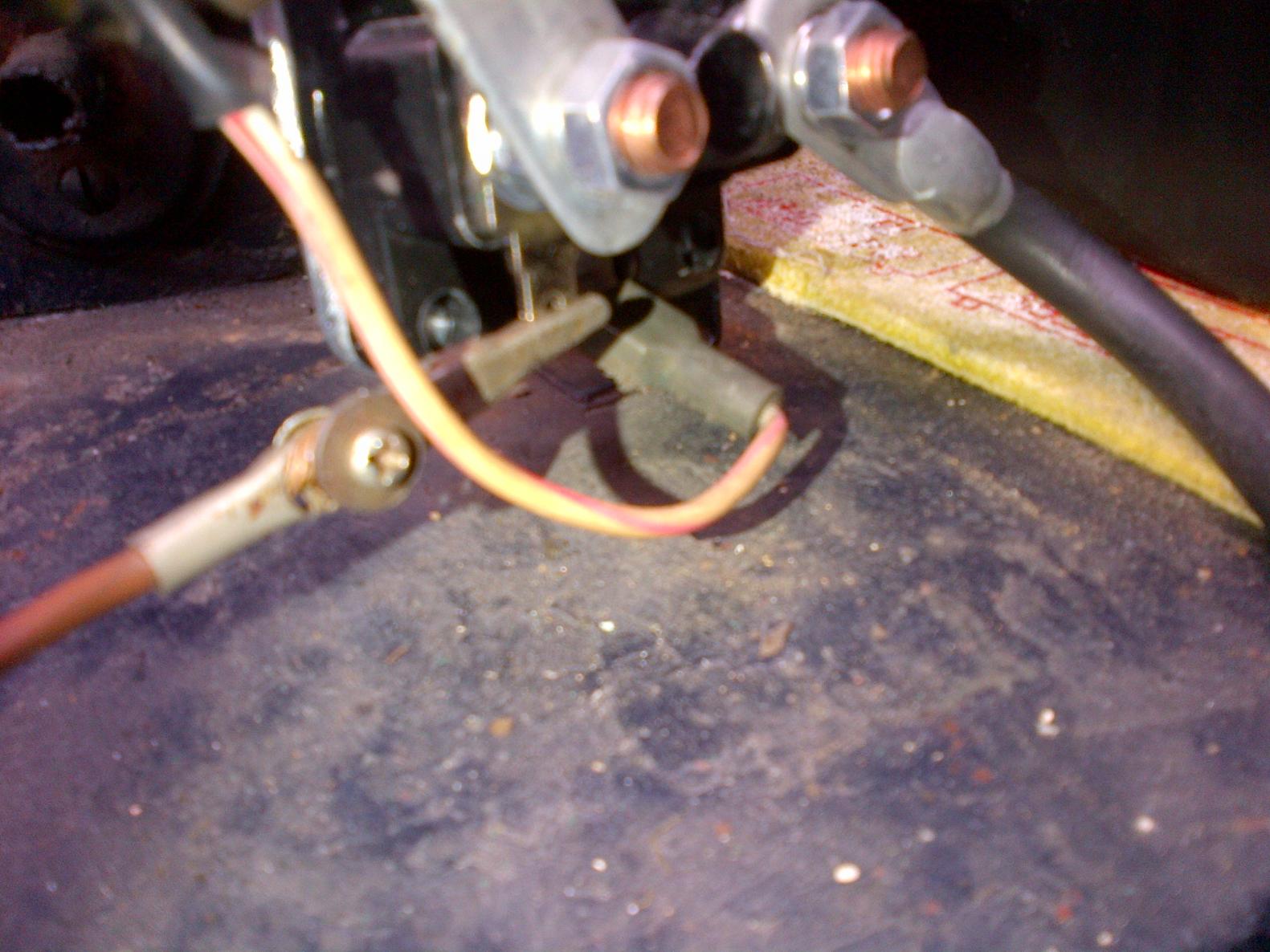

I doubt this is your problem, but just a thought. If you run the big cable to the input (battery) side of the original solenoid, it will get more power to the starter motor. You can run a separate smaller wire from the output of the original solenoid to the control line (spade terminal) of the integral solenoid.
Hi guys - so I cleaned and reconnected all of the battery and ground connections, no difference.
When, however, I did the above as suggested by Randall she fired right up. I tested this by disconnecting the spade wire (on the high torque starter that was connected to the large power cable connected to the main terminal on the starter) and jumped it to the open spade terminal on the starter solenoid on the body of the car, as pictured here (alligator clip).
This terminal (were alligator clip is attached) appears to be always hot and the starter clicks when it is connected. I am pretty sure I don't what that always on so I evidently need to pick a different terminal but am not sure which one to use.
Thanks guys - getting close... Hope everyone is have a good Sunday (and everyone is thawing out up North and back East)

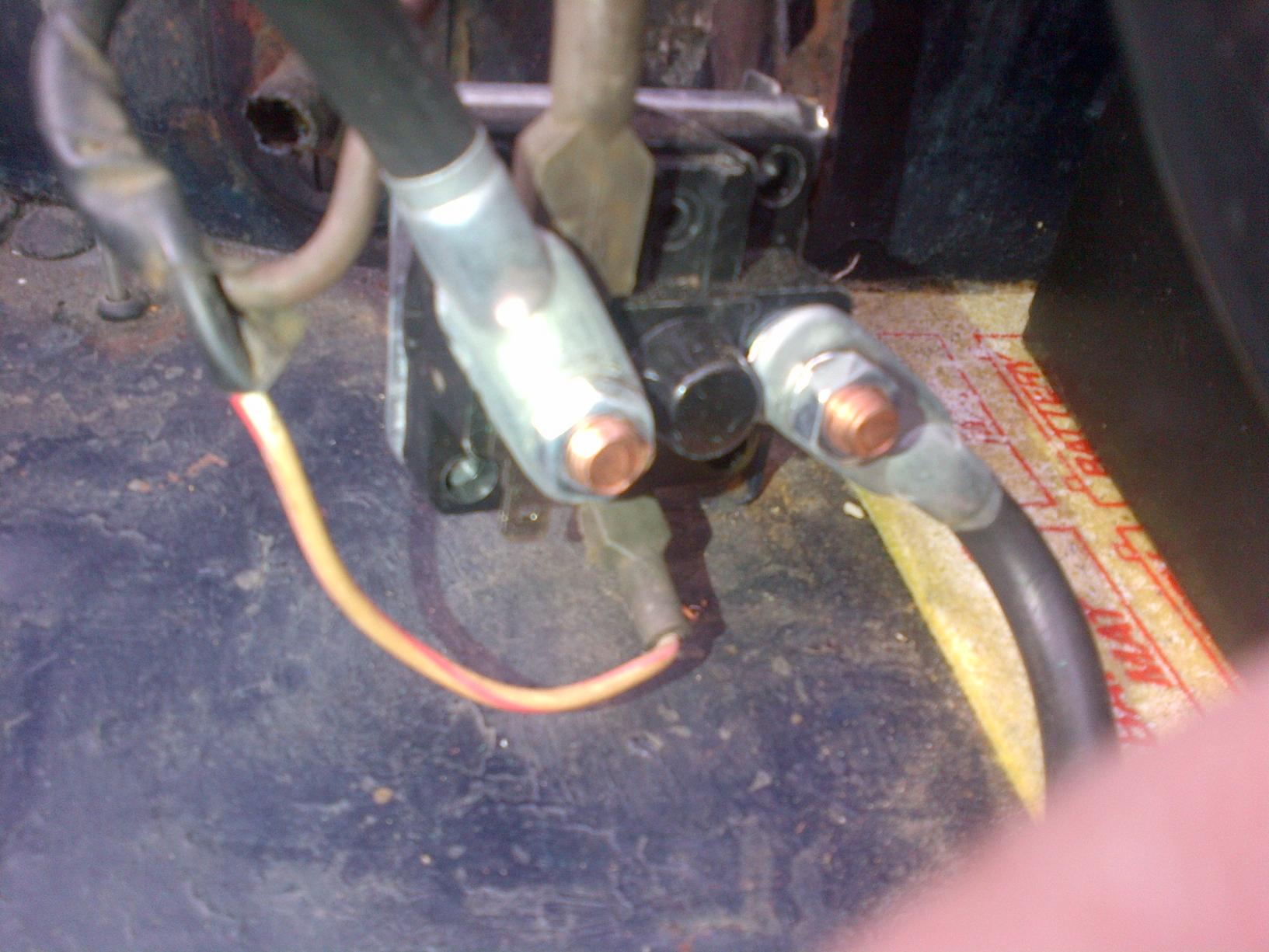

Hi Tom - standard high torque starter, one large post and one spade terminal. Here is a picture of how the starter solenoid is currently set up.
Large terminal with thick black cable is to battery, thick black cable on the right goes to the starter. Bottom wire is white/red, top is solid brown.
Open spade terminal on bottom to immediate left of the red/white wire is where I attached the alligator clip above to jump the starter per the post above.
