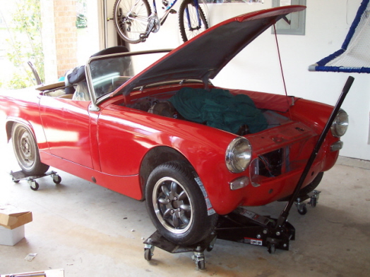

Sumitomo and some others have a 175-50-13. I bought one Nexen 175-60 just to see the fit..they are a low profile tire!
I know...its on 'backwards' in the one pic..it was only to check the fit :smile:
I think they would look good if one lowered the car 1" or more to reduce the gap from tire to fender..
I ended up going with the standard 175-70s..I figure if I am not happy with the pick-up..I can either put my 4.22 back in..or go to the 60 series.

Jim_Gruber
Looks like you're missing the engine to have the wheel well that open. Either that or just put on new springs and the usual suspects sent you a set of RB Spridget Springs. How is the fit at the rear? I'm thinking I need to remove the lowering kit in the front if I want to go with wider tires.

64rocksprite
Jim,
Thanks - i wasn't sure if I'd like the charcoal grey centers..on a red car, but it looks OK I think!
Sorry, I confused you guys..these are pics with the 175-60s..I went with the 175-70s to better fill the wheel wells. (sorry no pics)
Those are original springs..and the engine is in..those tires are that low profile and leave LOTS of space. They would good with a lowering though.
