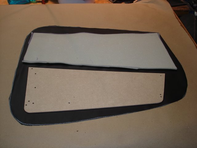

Here is what came in the Moss Motors interior kit. Anyone know how they are supposed to go together? I thought the top of the pocket was supposed to be metal that could be shaped to fit, but all that in the kit is what you see in the picture. My car came pocketless, so don't know if the metal stiffener is a part that you are supposed to transfer off the old pocket.

Looks like you need to transfer the 4 metal pieces from the old ones. That said I've never had to buy anything from Moss so I don't know if they offer them? The holes in the lower part of the picture do match the metal brackets from the looks of it. The upper two holes are the ones that have a formed piece that is shaped slightly. Most are bowed from people pulling on them over the years.

Yup! The metal "pieces"/brackets referred to are important as they are what attatches that panel to the doors!

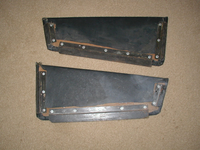

I have one taken apart. I'll take a picture of the top pice when I get home.
Rik
Those brackets are in a Z shape except the center portion is straight up and down instead of angled as in a Z. The center is only slightly wider than the door metal thickness. On Tonys set I glued (spray adhesive) a piece of heavy paper on the front (thin foam may also be used) to cover the rivets. I use Weldwood contact cement (but not the green can, water cleanup) and for good LONG adhesion, I coat both pieces to be glued and totally let the first coat dry and then coat both pieces again and let them get somewhere between tacky and dry before sticking them together. I use twice as much glue, but this seems to work (for me) the best since the EPA won't let me buy Neoprene adhesive in quarts anymore. Hope I explained this well enough. I know what I am doing but have a hard time explaining in writing.

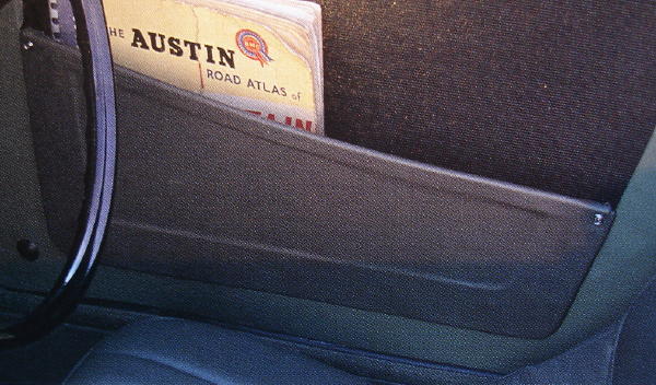

Here is a picture I found in one of my Sprite/Midget reference books. Is this what the front of the pocket is supposed to look like? I'm referring to the indented look of the panel.

Here are some pics of the top piece. I might have to start making these, there seems to be quite a market for them.
Mine didn't look like that & neither did the ones I got from Ray.

Those indents, or should I say the raised edges are simple cardboard strips glued over the split rivets that hold the metal to the masonite board.

The top peice is actually a u shaped peice and provides the bow in the pannel. The raised edges all around are correct and the S or Z shaped peices are for the bottom and sides and are indeed riveted on the pannel.
