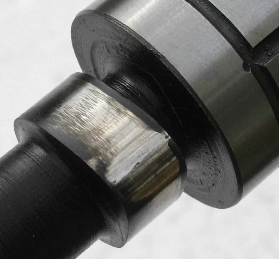

The cam bearings and journals look good. Several (3) of the front lobes have an imperfection running fore and aft just before the top of the lobe. I am assuming this is wear/pitting. Should I run this cam? The picture shows the lobe with the worst wear. It is where the bright wear mark goes across the entire lobe from front to back. It is not a depression.
Thanks for any advice. Jim

About the 1275: It has the late smog head with the big bosses around the exhaust valve guides. Is there anything to be gained my removing them? Remember, this is a budget rebuild. A professional porting job is out. If I can pick up better breathing for minimum cost I'd do it.
I used a similar head (the 12G1316 - that has all the plugs where it used to be hooked up to an emission system). Rebuilt it just fine (but no porting or anything fancy), and didn't make any other changes (except seats, valve guides and the usual). In my case, I had to repair those brass blanking plugs (where they remove them and thread them back in).
