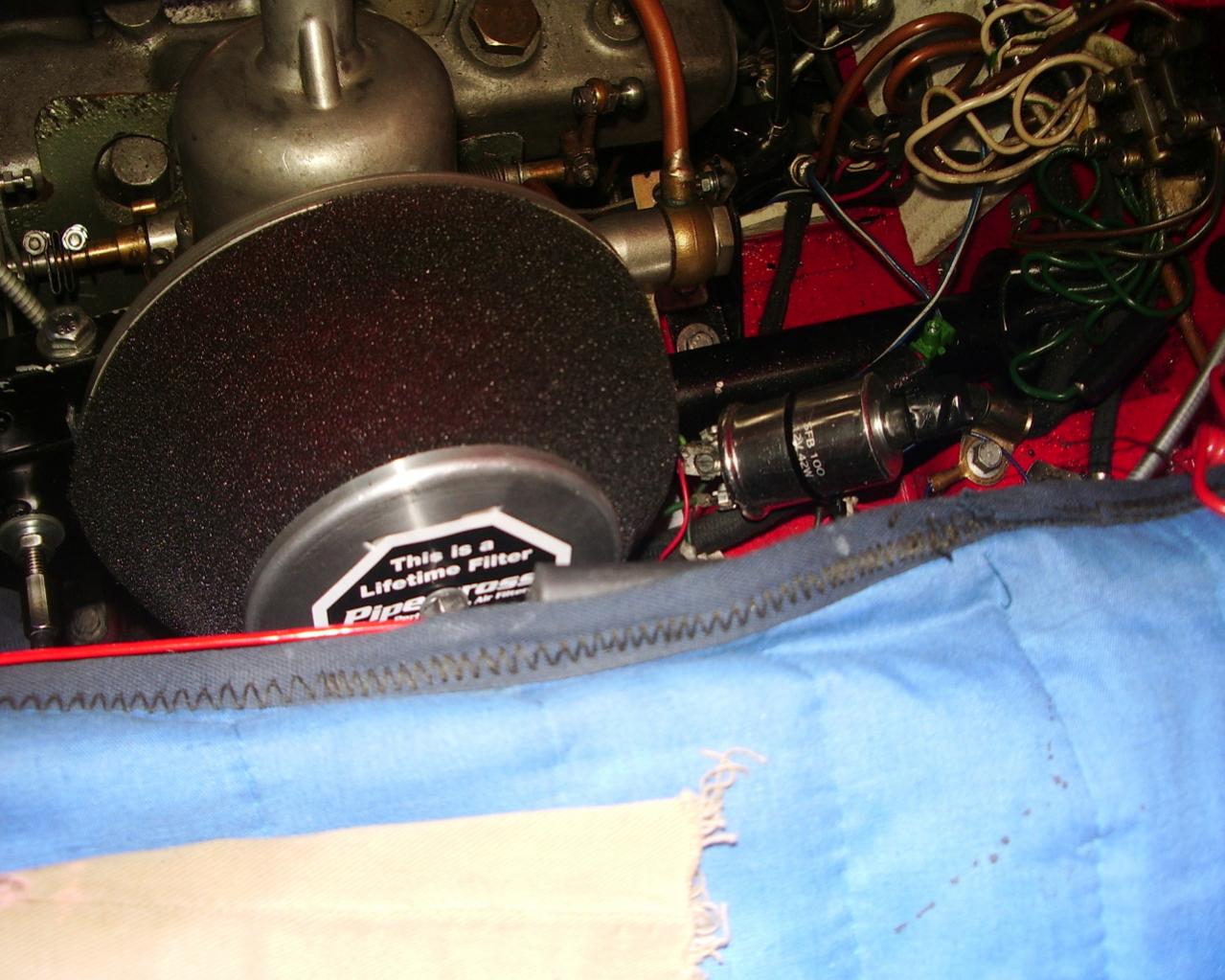

more than thousand page long, I am become convinced that my pancake Air Filters aren't the better solution for my AH 100/6
The first choice was K&N but I never found one good solution, ready for my twin SU 1"3/4
so look around I have find a Sponge Cone Filter ready to fit to my car It is present on AHspares catalogue - but can be ordered directly from
this site (NCI) https://www.thepipercrossshop.co.uk/pipercross-px150-mini--metro-su-air-filter_p23378647.htm
(SU HS6 1.75 must be specified)

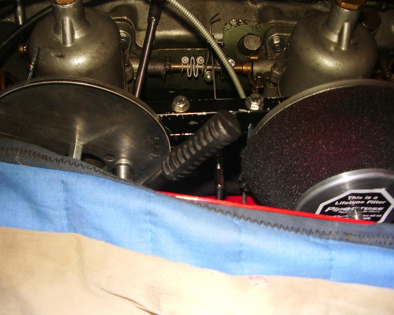

They fit perfectly in the restricted space of my AH, BUT remember first begin from the forward carburetor,
that are so strictly that I have prefered to saw the upper part of the top Aluminium (just 15mm) -underside you find soft rubber end - welded to the
sponge so the integrity is safe
The rear AF haven't problem.

I have one long road test with the new AirFilters and the car appear to be more responsive and with more power -
also the fuel beverage appear decreased
BUT this is only a personal impression -
I have NOT the instruments for a serious test, sure the filters surfaces, in square cm, are more than doubledIMGP2171.jpg in respect to the oldest AF,
and avoided the resonance problems, due to the thin space of filtration (reported on the MGB article)
