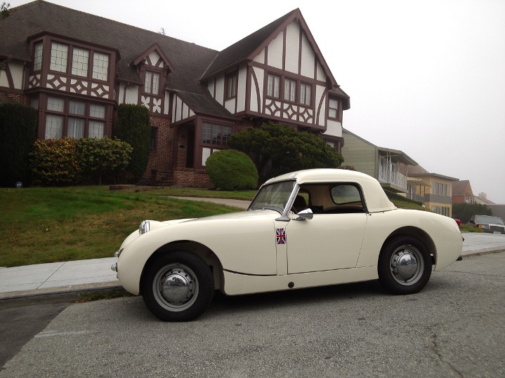

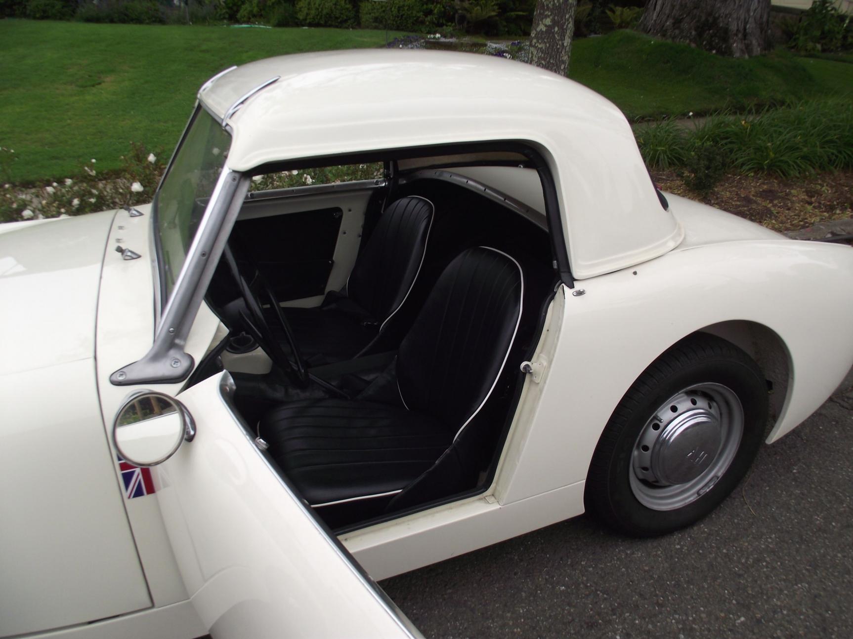

Jim,
If this turns out not to be the car for him, I have a friend that is ready to sell his OEW Bugeye this coming week. It is a very original car in exceptional shape. It has been repainted the original color, along with the original factory hardtop, but is otherwise completely original. I've driven this car and it runs and rides great. I'd like to see it go to a good home.
BTW, wire wheel width difference is not 3/4", it's 1 inch (1/2" per side).

Nice car Gerard. Well I was close on axle length. I knew it was something like that. Thanks.

Thanks Jim,
You can't tell from these photos, but things like the ribbed mats in the doors are original, as are the the Hardura mats on the jump seat and wheel arches. The floor have rubber mats, not carpeting, but not sure if they are original or the Amco mats of the day. Except for a remote filter setup, everything under the bonnet is intact as well.
