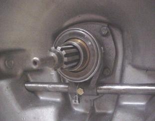

Very common. Most guys add insurance by drilling a hole through the fork and shaft and adding a nut and bolt.
Edit: Here's a picture...

Well I'm almost certain I have a broken crosshaft. I can move the shaft up and down a significant amount. Years ago when I added the extra bolt I followed the instructions in the BS Shaller book which was to tap out the original taper bore and install a 3/8" Gr.8 bolt rather than use the method pictured above that martx-5 shows. I think my fix worked well for a time but maybe the extra tension from the new slave spring was enough to weaken the reduced amount of metal on the crosshaft around the larger bolt? Next fix will be like the one in the pic. Had to happen in the Fall the best time to drive an LBC. :-(

On my TR4 I had a chance to examine the pin when I had the gearbox out for a pressure plate problem. It had a decided bow in it. Guess that is one advantage of a non-hardened pin. It got replace of course and the extra bolt added (in fact, that is it in the above pic).
