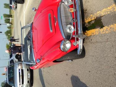

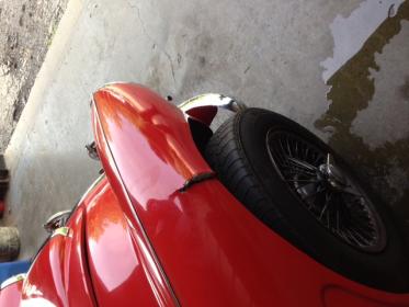

So I have been working on my BJ7 for a couple years now (thanks to everyone here) and yesterday an oblivious elderly man turned right on red directly in front of me. I have Hagerty insurance which I am being told is a great thing but I was wondering how I go about this? My car is almost perfect mechanically but definitely could use a respray. (The paint is in pretty rough shape) I know there is a lot of nastiness living below the paint so I am not sure what I am dealing with yet. My dilemma is that this car is a driver and will always be a driver so I am not looking to do a restoration...just a nice looking driver. Am I going to be stuck footing a bill to do the body work on the tail and driver's side? I wasn't planning on doing any body work but I can't imagine it makes sense to only paint the damaged areas as long as the car will be apart. I am at a total loss (no pun intended) on what to do and I would appreciate any help or advice from anyone that has been in this same situation. Thanks so much in advance for any guidance you can give. image(5).jpgimage(6).jpgimage(2).jpgimage(4).jpgimage.jpgimage(3).jpg

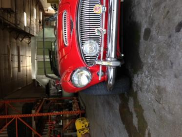

Hey CP77BJ7,
Ouch, that hurt ! You should be in great shape with Hagerty as your insurance. I would assume they will have an adjuster come look at it but one thing I would really hold out for would be a complete respray as going to be almost impossible to match a red paint job unless it is brand new. I know they have all those hand held computers that scan the paint and supposedly come up with an exact match, but in my experience they never get it exactly correct. You will obviously have to repair the damage as shown and certainly looks repairable with either a good body man or new sheet metal - hold out for Kilmartin sheet metal ! So damage got into front shroud, fender, and cannot quite tell if the door got dinged too. But either way, they would have to replace or repair the fender ( looks like it needs replacing to me), straighten the headlamp area, maybe the hood, maybe the door, can't tell. If the adjuster just wants to do that and then respray those area only, you'll end up with a front shroud, right fender, maybe hood, maybe right side door and then will all that match the rest of the Healey ? Take off your stainless steel beading when they go to paint as never looks right if they try to tape it up. Anyway, I would really try to get a complete respray so everything matches !

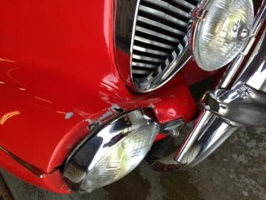

Thanks Mike for your help. The fender is pushed into the door and it does not open. The hood is also bent and a hinge is either damaged or a weld broke connecting the hinge to the hood. The front shroud is literally folded over itself into the grill and I can't imagine that part is repairable. Also, the aluminum is torn where the screws attach to the fender. Being that the paint is pretty rough to begin with should I try to see if Hagerty would pick up any of the tab to paint the whole car or would they just laugh at me? I know I would be responsible for any prep work required for the rest of the car but I wonder if they would pick up the painting cost.
I went back out to look at it and there is definitely suspension/ steering damage too. :( Thanks again for the help as I have never dealt with something like this.

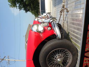

If you look at my last picture you can see how the aluminum folded over itself and is torn at the screws. I cannot imagine that the shroud is repairable. Also in the last pic, notice how the horizontal plastic piece between the bumper and shroud is gone? That shows how everything is pushed in about 4-6 inches. I am nervous that they may total it too. I think it may be a lot worse than in looks at first sight. The beading popped out above the headlight too so I imagine that the panels are torn there too. BTW, I think I had it insured for too little...$37,000. I had been meaning to raise it up another 10k but never got around to it. Never thought it would make a difference but I guess I underestimated the impact that one idiot driver could cause!!!

Writing it off may not be as bad as it sounds if you have the option of keeping the car and being paid out the insured cost minus the estimated repair cost. Unless your local regs require the registration to be cancelled in the process.
I'd second any comment about finding the right person to weld the aluminum shroud. Anyone can weld it but the question is how long do the welds last before cracking.
