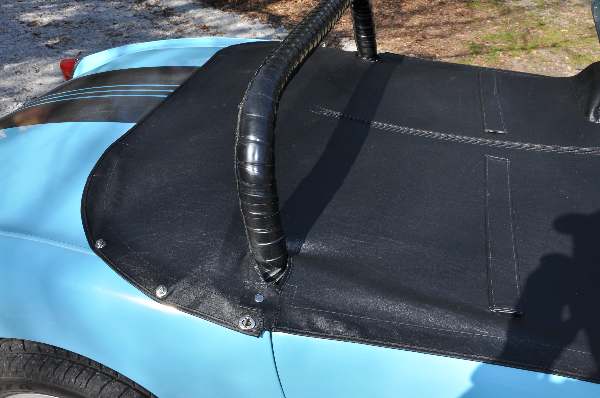

For those of you who have roll bars, has anybody made a tonneau to fit around the bars? If not, I might just have to make one. My second midget has a bar and I would like to put it back in because its the rubber bumper version and sits a bit taller and more chance of rolling over. I didn't realize the early midgets had that bar to keep the tonneau up. I guess the need went away with the flip down top models because the top folded under there tends to hold up the tonnea on those.
Gundy
I had a local shop cut and edge a hole for the bar.
It was very reasonable and the guy did it in about 20 minutes
while I watched.
