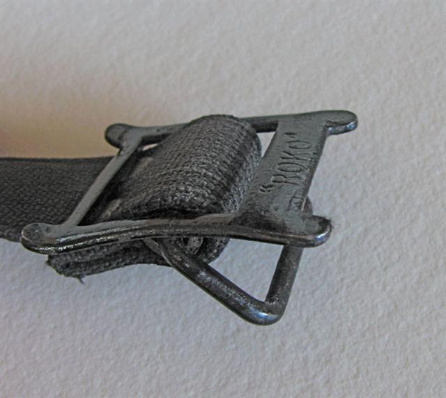

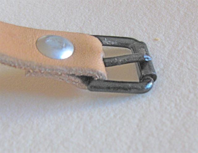

If you look under the rear cockpit comming you will see a stifner bar thing across the car. It has a small slot in it in the center of the car.
This is for a leather strap 8.5 inchs long, black, with a standard buckel with a roller on the end of it. It is to hold the top bow tight when it is in the down position. Try your local pet store.

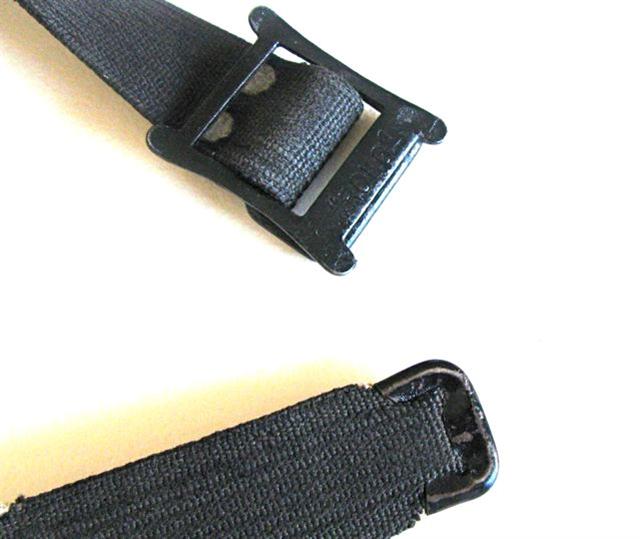

There are also two straps, black, that go around the top bow and your top when it is rolled into a storage position. They are supose to be 18.5 inchs long with buckles.
I should think this is for any side curtain spridget.
Now, if we can just find a source.

There's a guys that posts often on ebay that not only has these straps made to original specs but the spare tire straps and felt pads as well. I bought all mine from him a couple of years ago. Excellent quality. I'll try to find his name.
