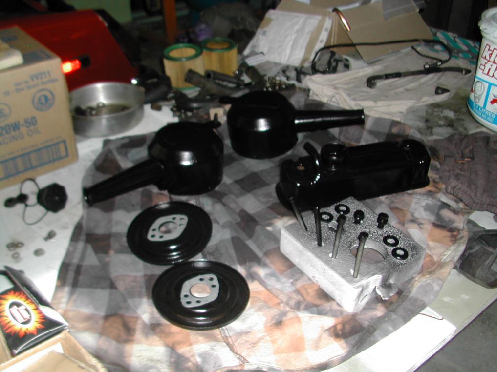

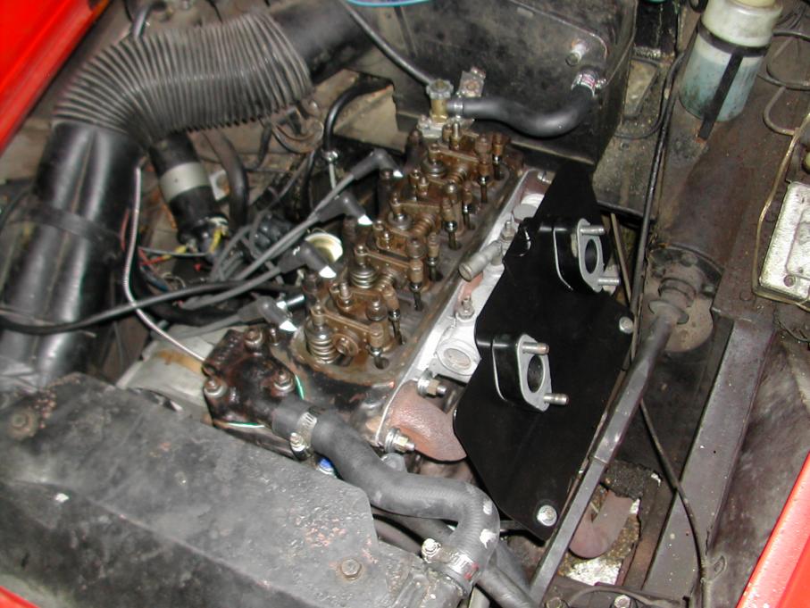

Well as all jobs start out, last fall I decided I had to get the seized #3 sparkplug out that had been in there since I got the car in the fall of 2010... plug would not come out, so off comes the head & soak the plug from backside with 50/50 tranny fluid & acetone... does not budge... plan B, set the impact on a low setting, bit my lip & walk the plug out... success & no stripped threads, thread chaser & voila ! Plug threads in perfect & tightens up... notice the carb intake gaskets are non existent, manifold gasket non existent (replaced with generour dollops of high heat orange sealant - yikes !!, carbs had bee painted with silver paint by P.O., broken exhaust stud, corroded cross over coolant pipe, siezed temp sending unit (requiring a new dual gauge), incorrect manifold washers, head washers... and on & on we go as every Spridget job does :smile:
While the carb bodys soak in kleen-flo & the throttle shafts are being delivered I got everything else ready to go, one more weekend of work & I hope to fire er' up ! Everyone loves pictures so here is how the engine bay looks now (not a show car, just a maintained driver) & the rest of the sandblasted & painted bits awaiting installation.

Sounds like you've been busy. Do you have solid throttle discs or the ones with the poppits?
poppits... weird little things, apparently to reduce emissions when letting off throttle or something, think I read that somewhere... it's a 1974 mostly stock, HS2 "549's" on it, think 549 means something, had to use that # when ordering the kit, misread the "master" kit on the Moss site, or I would have already had the throttle shafts..., but then I would have had to order jets separately... meh same diff I suppose. First time rebuilding SU's I have done my share of Quadrajets, Motorcrafts, and even hammering out gaskets for an old updraft carb on my neighbours tractor & an old Holley on a 1948 International dumptruck, have read the"SU Carburettors Tuning Tips and Techniques" book over so I'm not to intimidated... has to be better than they were, by the looks of it it has been a long time (if ever) the carbs had been done... from what I have read usually new throttle shafts are all that's needed, hopefully the housing is okay, throttle shaft was noticeably worn on the one carb in particular... don't want to go down the rebushing road unless I have to !
Our size SU's seldom need rebushing. I'm betting the new throttle shafts will do the trick. May want to do in the poppet valve's on the throttle plates. Specially if they look worn. Had a engine swallow one which fortunately didn't do much damage. They do restrict flow though. Common to solder up the holes.
