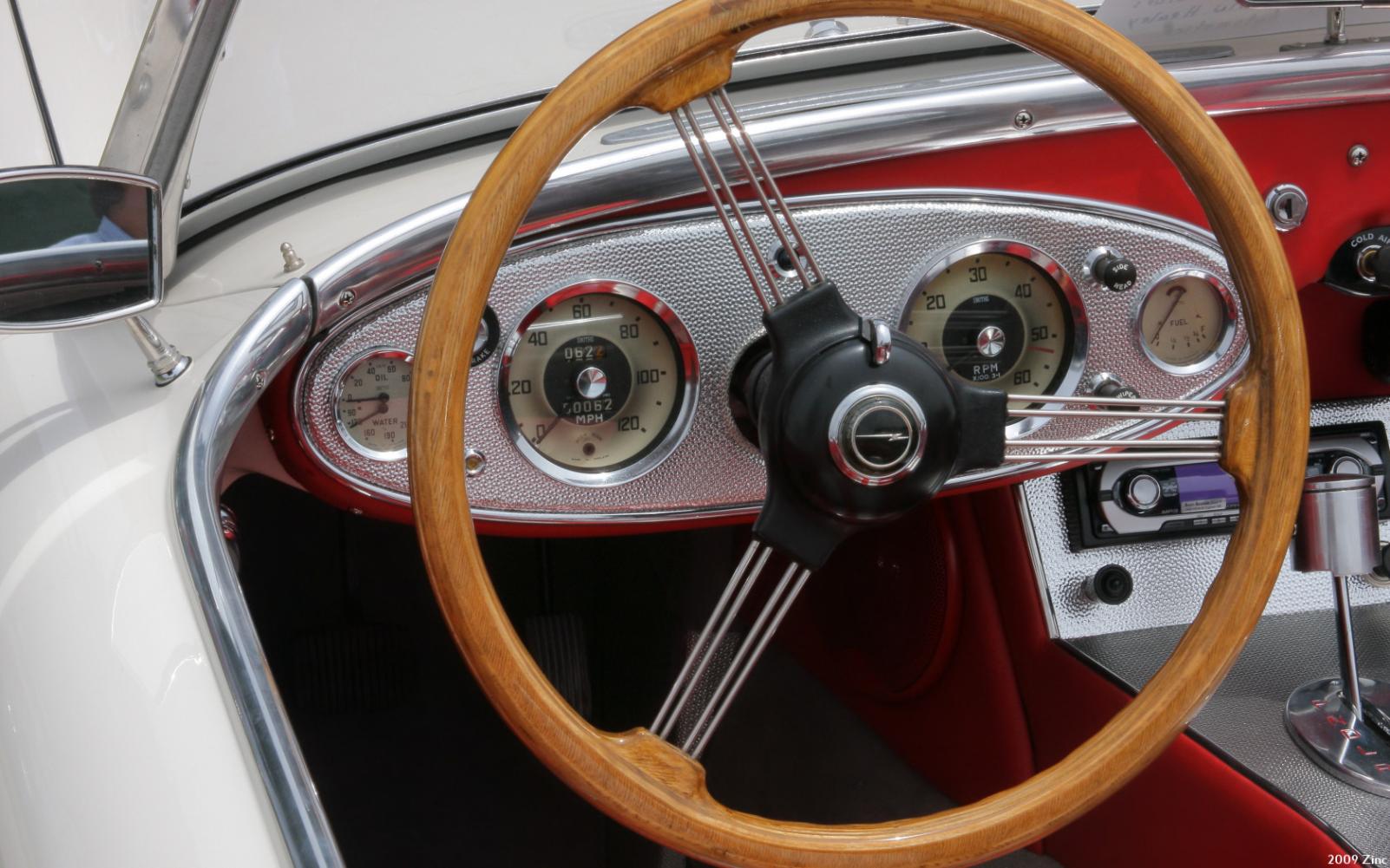

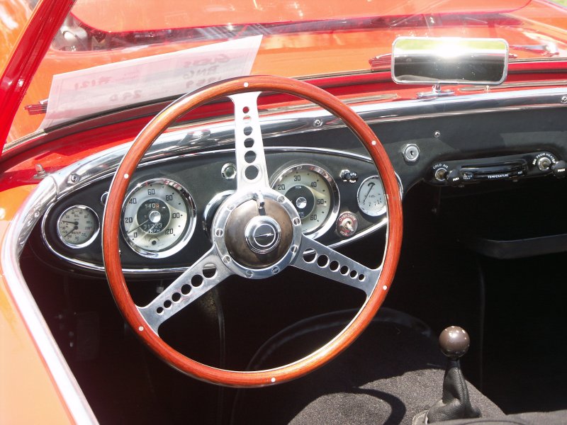

As Randy says, all the 6 cylinder cars came with the padded dash. I've seen several modified to be like the original 100's. Pictures below!

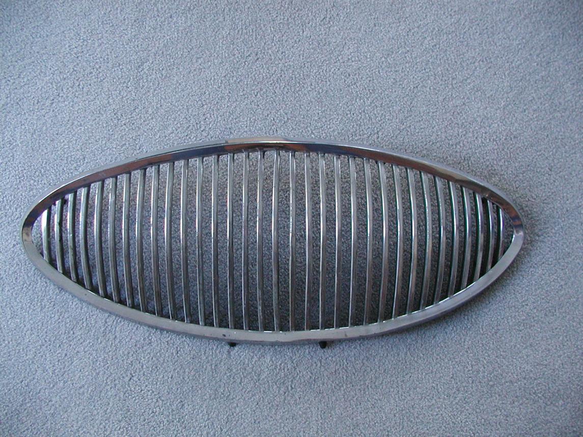

There were engine blocks, heads, windshields, tops frames, seats, hardware, tools, etc, just about everything you would need for a Healey. Some of the stuff was sold on EBay, and a large portion went to a collector in Holland, I think. There was even a used 100S grille! (Picture below.)

Yes, your tunnel came from there. The grill sold for $4K to someone in Europe who was building a 100S replica. It was fun to see one in person, it was surprisingly heavy!
