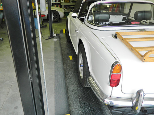

Not a great pic to look at the tires/wheels exactly but here's a shot with my 5.5 rims and 165-15 Kumhos. I can take a closeup of the tire/wheel fit for you if you want - but I think they fit fine on the rims and don't look too skinny.

Thanks for pic, Randy. The car looks great. The 5.5 wheel and 165 tires look good, unfortunately the Kumho (which I like) in that size is no longer available. I think the perfect size may be a 185-70, I found those in Pirelli at $202. each, Ouch!

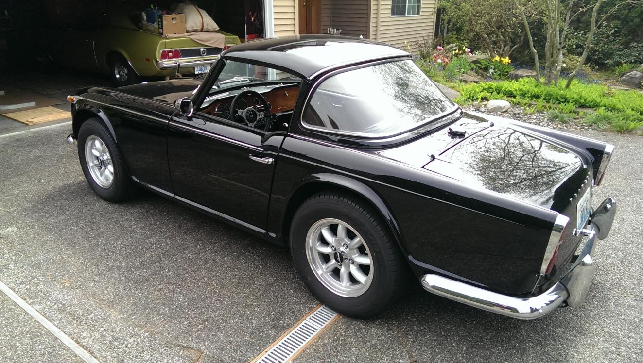

Here's my car with 205/70 Yokohama's mounted to 5.5" Panasports. Diameter is close to correct, and the tires do not extend beyond fenders.
