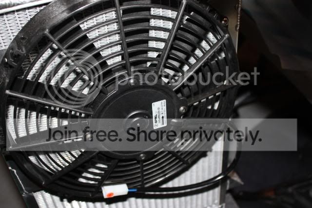

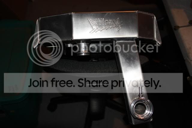

I purchased A Wizard aluminum rad complete with a SPAL fan mounted and a fan eliminator kit for my 3A restoration. It is a drop in rad that utilizes the stock mounting locations.
If you want some pics, let me know.
Cheers,
M. Pied Lourd
M_Pied_Lourd
Here are some pics
Price was 645.00 with the fan mounted/fan wiring and relay kit/fan eliminator. Purchased from Art Lipp.
Cheers,
M. Pied Lourd

Radiator looks great. I searched today and noticed Wizard and TRF had
them. Do you mind if I ask why you chose Wizard over TRF.
Do you like your radiator? Is the fan necessary?

M_Pied_Lourd
Hi Paul,
I chose Wizard as I have a TR6 as well with a Wizard Rad installed and it works great.
I don't have my 3 on the road as of yet as it is undergoing a frame off restoration.
I don't think that the e fan is necessary if your car has been well maintained...however, with the fan eliminator, it will lose some weight off the front of the engine and that will be a good thing.
I am pretty confident based on what I have seen on here and what I have seen in person that this will be a good set up for me.
