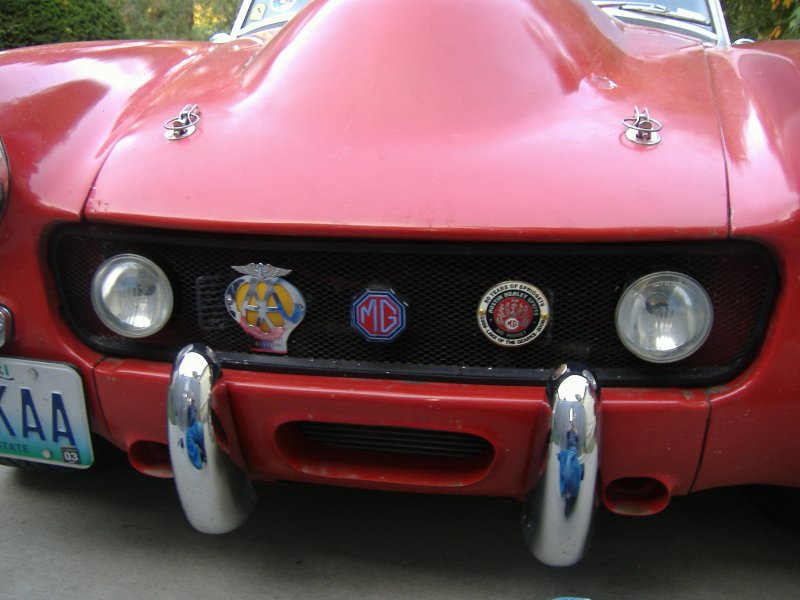

I mounted a set of GM driving lights in the grill area on my Midget along with a mesh grill insert. They do help and I think the size is in proportion to the car.
bill_young
No, they're just Bugeye rear bumpers mounted upside down on home made brackets. I used the same in the rear. I did want a bit of the "Cobra" look though.
