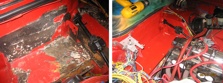

I can't contribute a whole lot of really useful
restoration procedures but I can refurbish just about
anything. The battery area in my TR was in pretty bad
shape from years of dripping acid I guess.
Here is a before/after photo of a fairly easy and quick
battery deck refurbish I just completed. If anyone is
interested, I will post the procedure in step by step
photos.
When my TR comes back to life, at least it will look
good!!

Looks nice, Dale, but what are those little screw-head looking devices laid out atop the table? The battery tray is an integral part of the scuttle and in turn helps to keep the integrity of the body together as well as prevent "scuttle shake". If that a plate over the old shelf and how is it sealed? Just curious.

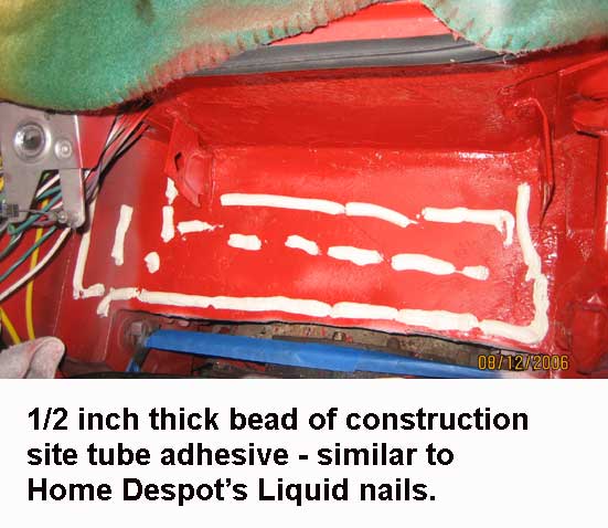

Bill, the battery deck was pretty beat up and uneven.
I cleaned it up, got rid of everything bad I could reach.
Then a primer coat and two coats of high temperature
engine paint to match my engine area.
see attached photo
I used .040" aluminum sheet stock because it is easy to
work but is stiff enough to span the many small dents
and bridge the weakened 90* bend that was present.
I installed ribbon strips of construction adhesive to
stop any noise and then compressed and spread the adhesive
with 8 each, stainless steel tek screws.
Remember my car is dead in my garage and I am yanking
out PO duct tape, rubber cement and paper clip
halfassed repairs. I cannot begin to afford to bring
welding guys over to my house to install thin sheet
body shell steel.
My new deck looks much better, it added some strength,
it will function and it raised my spirits when I saw the
finished product.
It is far superior to the PO spray painting directly
over rust, yes??
I just want my car to be un-dead!!
Tinster
