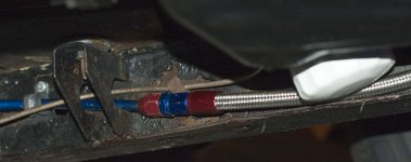

Alan, My next big hurdle after the wiring is done(almost there.Whey!)is the fuel lines. I have been thinking the same as you where to run the lines. Was planning to cross over at the cross member too. I notice you used 3/8s for the fuelas it is FI I guess it needs bigger and strong er lines. I was planning on running 5/16 for mine. How did you join the line and the AN fittings. If you can I would like some underneath photos @croosmember connection and how you brought it up to the intake. Very nice I am impressed. I hope mine will look half as nice.

Summit sell hardline to AN adapters. Make sure you get the ones with the compression nipple inside I'll post pics in a minute.

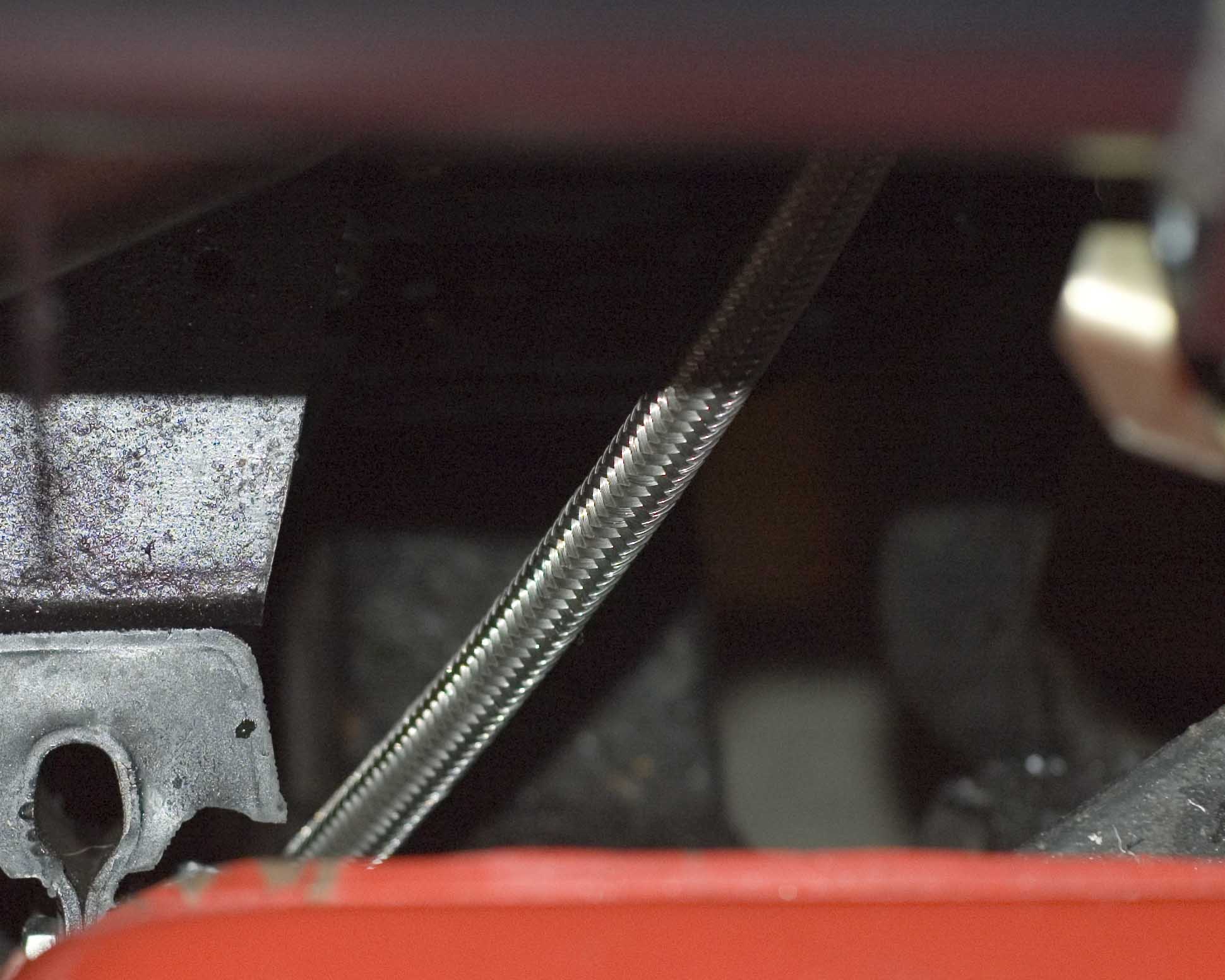

Ok, here are 3 poor shots of the connections, and the routing. It's dark and cold out there, so I'm not hanging around, but you get the idea.
The wiring is a work in progress, so don't let it distract you...
