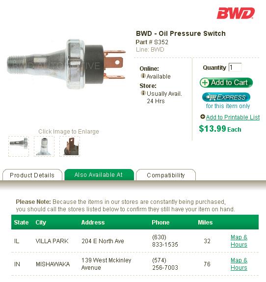

Does anyone know any other applications for the 3 contact oil pressure switch used in the '74 TR6? I think it could have been a mid 60's Chevy or something similar. Mine just gave out and I want to source one locally since I have no other parts to order at this time.

TR3driver
Great Pumpkin - R.I.P
I don't know, but O'Reillys has it listed under 74 TR6.
Also, just a thought, if you aren't using the anti-runon solenoid then a single terminal switch will do. I still don't know an alternate application, but they are very common.

its just a normally closed switch and opens with pressure, NAPA also has them, the opposite of the type I used to turn on my electric fuel pump

I know the Standard brand part number is PS-64. Good quality part.
