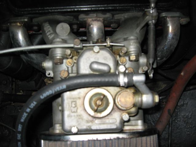

This past weekend, I had planned to verify my fuel mixture and idle are good to go. Unfortunately, once I started to dig into things I realized I am not sure where each of the adjustment screws are located. I pulled down the parts diagram from the Weber website but it did not help me.
I have attached a photo of my carb. Can someone help me figure out where each of the adjustment screws are?

Another shot of the carb. There is a fuel pressure regulator off of the fuel line.

Okay, got check out the teglerizer.com web site. Lots of good info on the dcoe side draft. Basically the idle mixture screws should be turned out 1 1/2 to 2 1/2 turns. If you are not able to get the idle mixture there, then further work is needed. One make sure the throttle is completely closed. Then check out the idle fuel jets. Probably in the area of 50 F9 or 45 F9, depending on your local climate.
Gray_Cat
Are you certain the weber is properly jetted for your car? If to lean, overheating occurs. Also, the timin needs to be spot on.

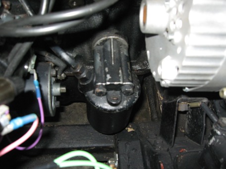

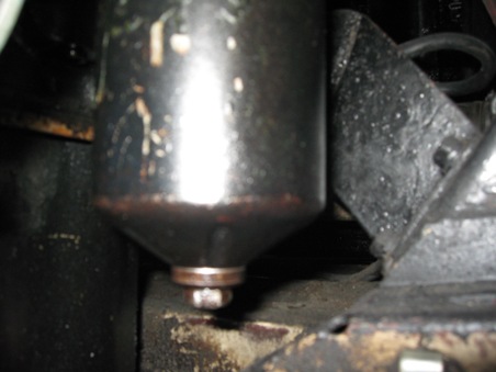

I need some help identifying which oil filter assembly I have on my car. I have attached some pictures. I noticed on Moss's site they show two different fileter assemblies with different seal part numbers. Can someone help me out here?
Thanks in advance.
