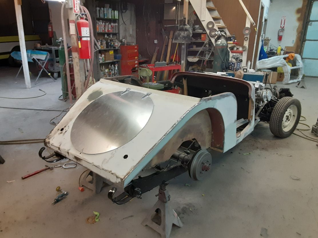

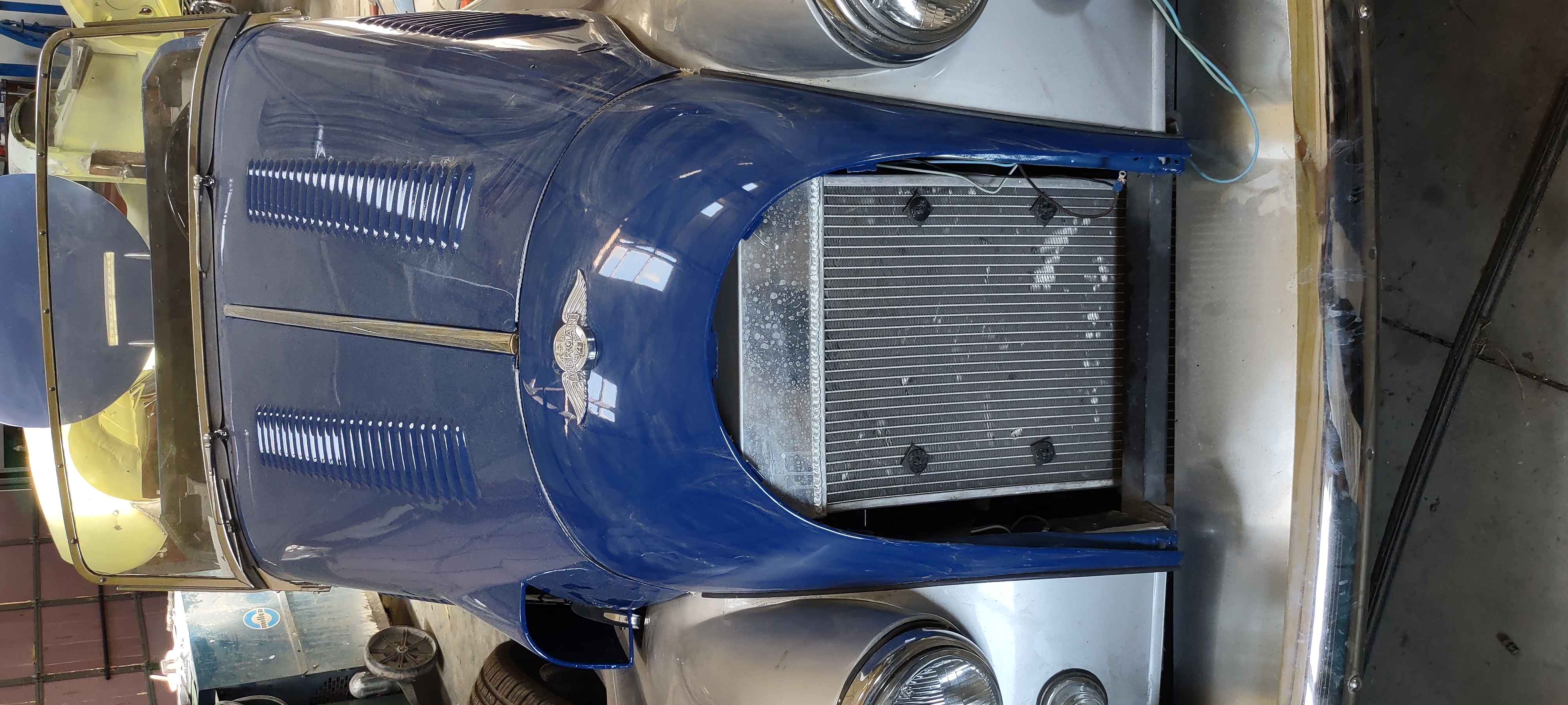

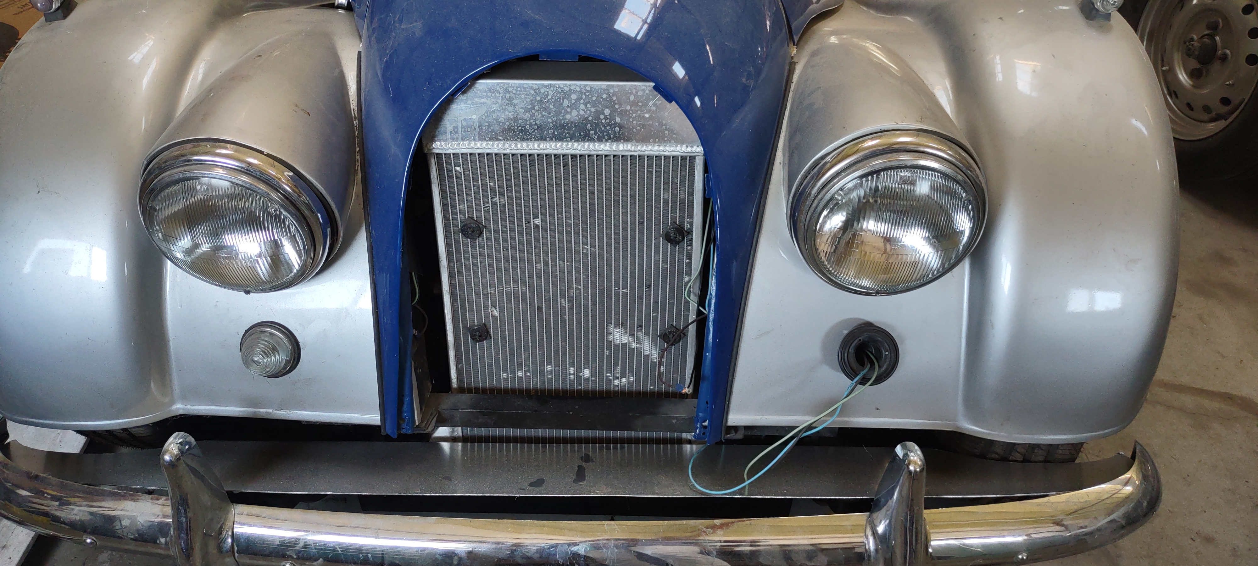

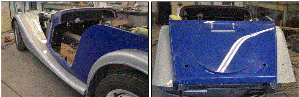

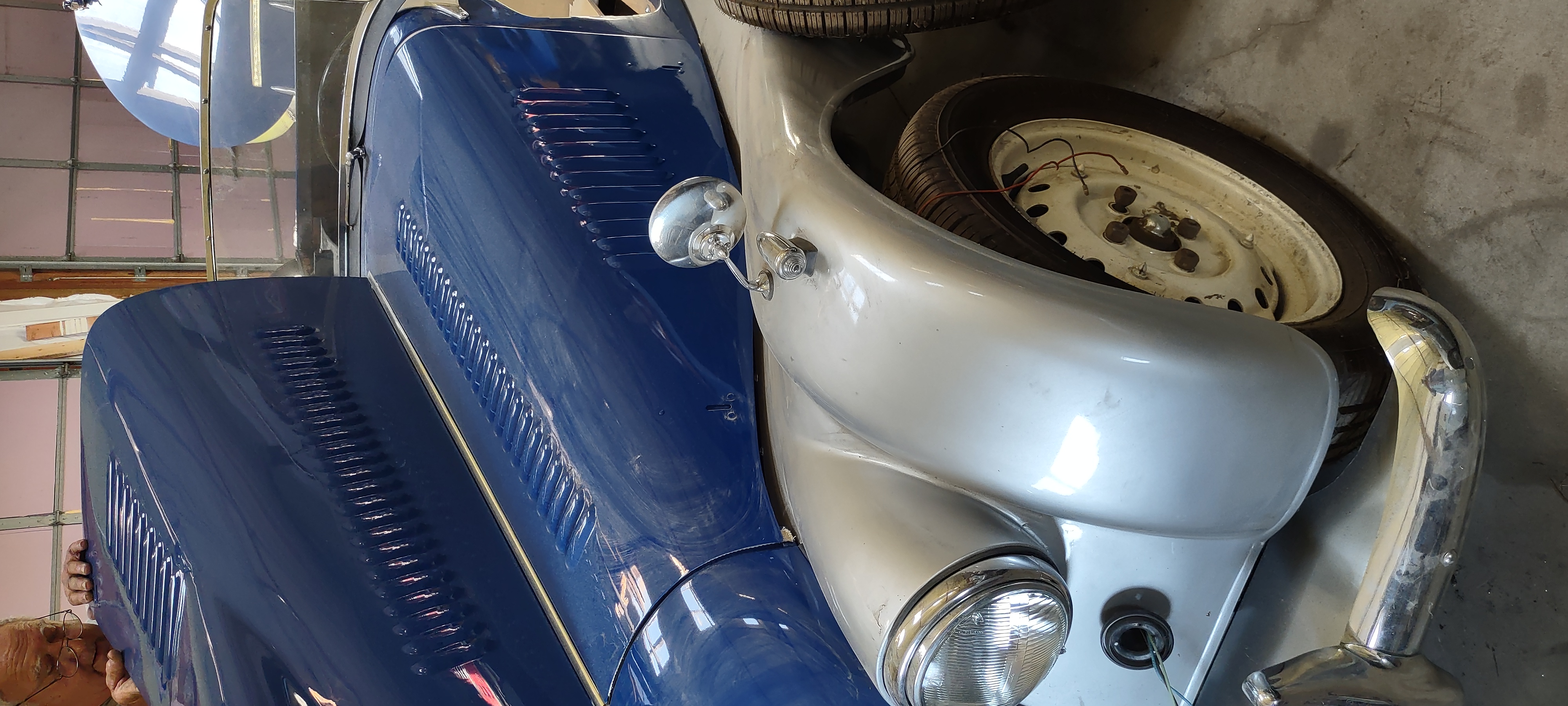

This car has been off the road since 1969 when it was severely damaged in a crash .I am getting close to having all
the upgrades completed. Tr4 front suspension/steering,Miata 1.6L /5speed ,tube shock conversion.
Here are some more pics....

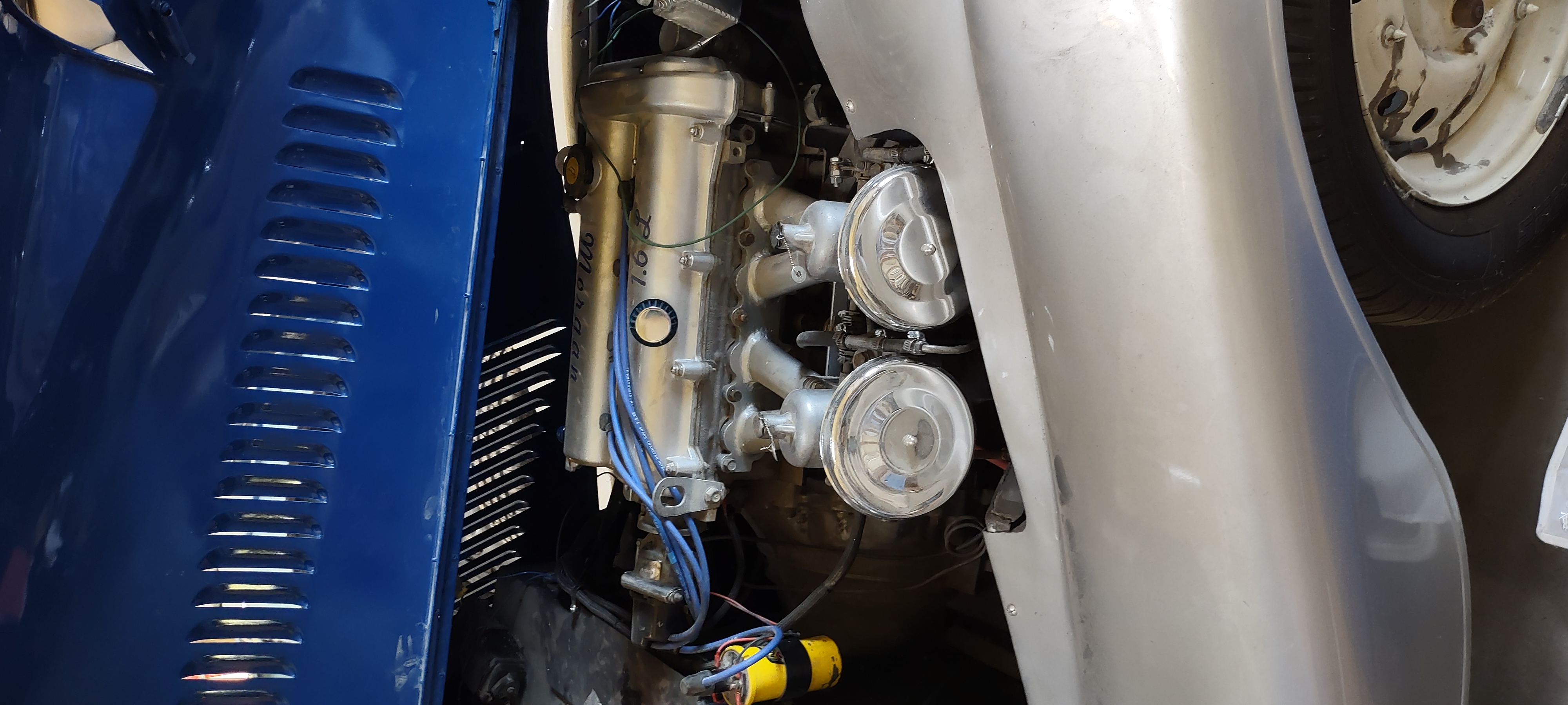

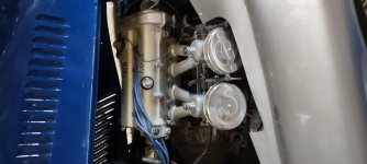

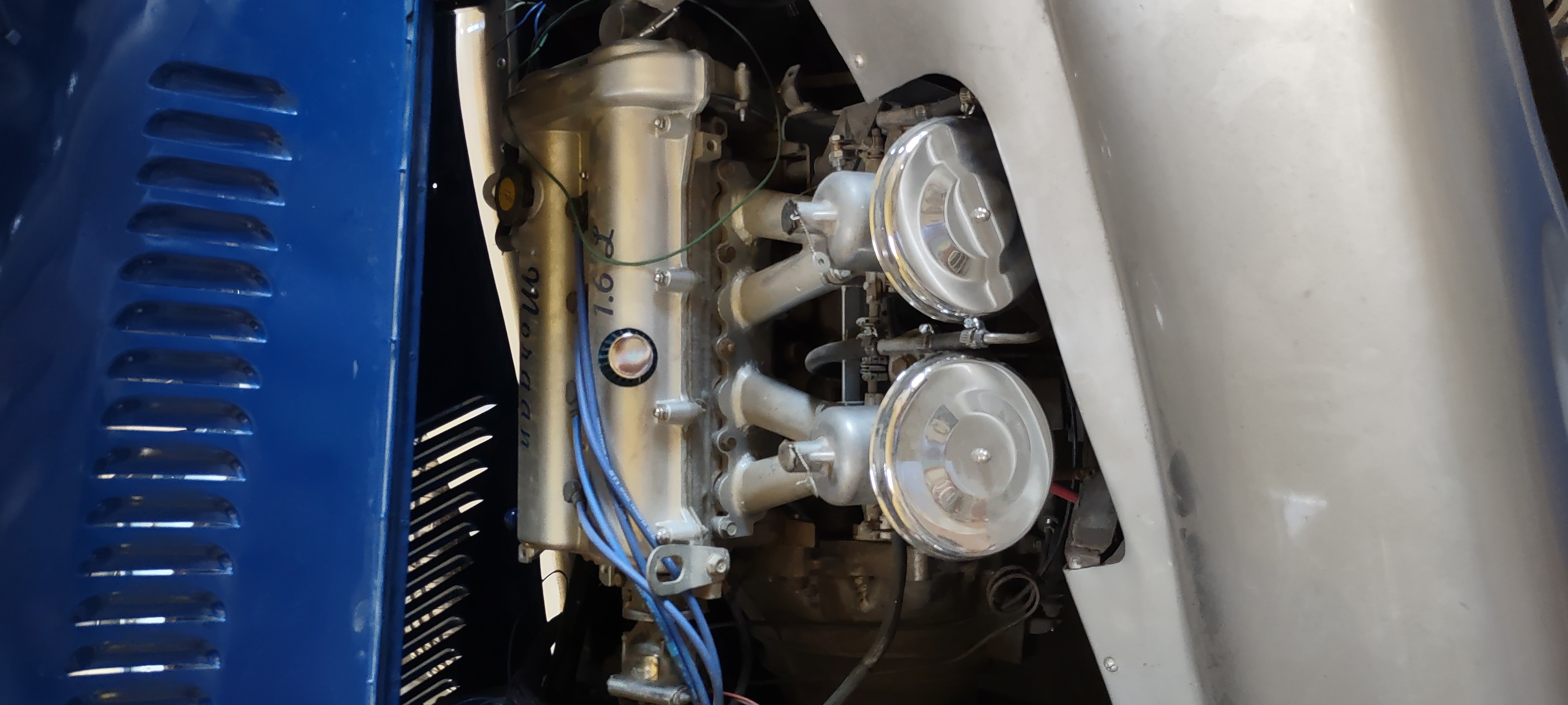

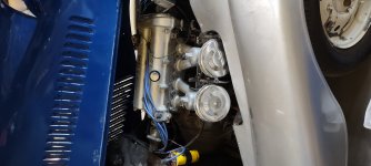

Looking good mc, I am building up my Panther Lima with a mx5 1.8, I'm interested in what you have done with the cam cover.
I drive an NA Miata, and I'm curious as to what you've done with the cam cover. It looks really good. Powder coated finish?
Sanded primed ,painted and cleared. The 175 SU's are on the manifold we used on the race car for several years. This picture
doesnt show the Lucas distributer ,that is a perfect fit to the 1.6 MX5. It is the perfect addition to the car as it will leak some oil

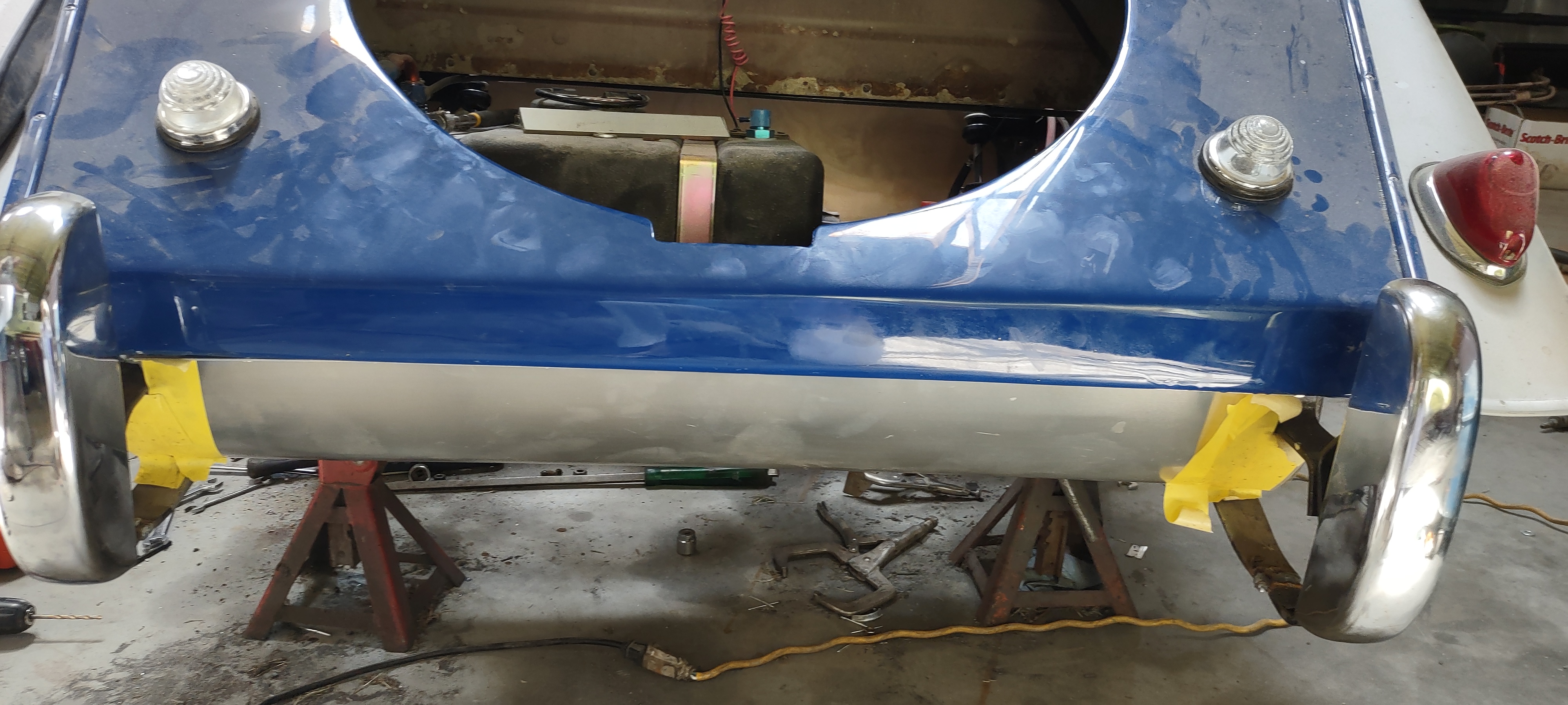

and keep up a fine British tradition . I will get some more pics these are old and the car is much closer to finished now.

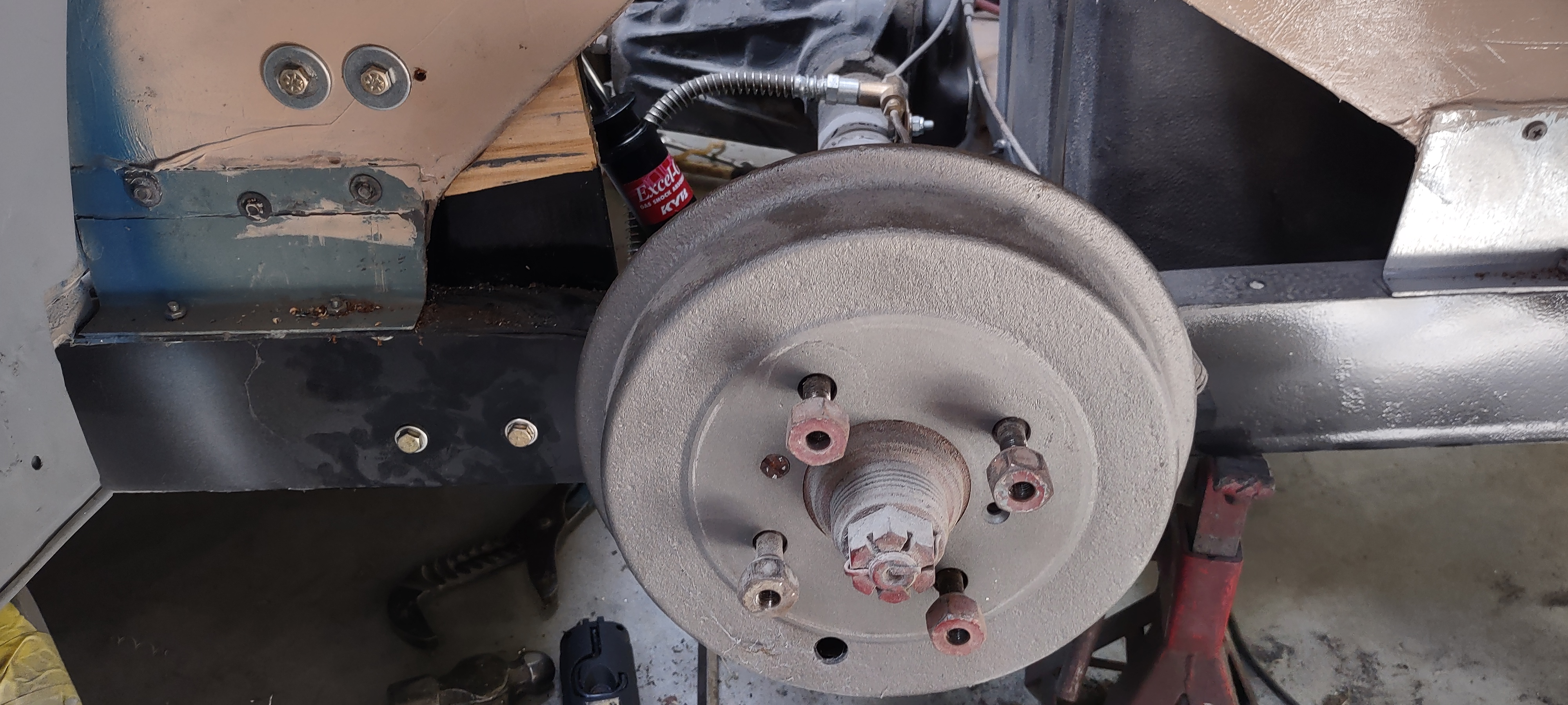

Just completed a tube shock conversion in the rear. Pics to follow.
