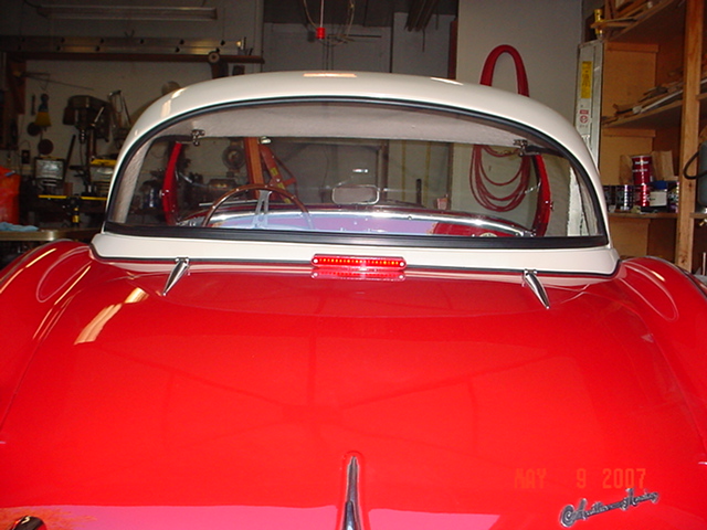

I know you were considering magnet mount. If you would consider permanent mount I used the following:
https://www.julianos.com/3rd_brake_light.html
With the pedestal removed it mounts very close to the surface. Painted body color It blends in well with the car. It has very bright leds.
See the attached pic,
D
