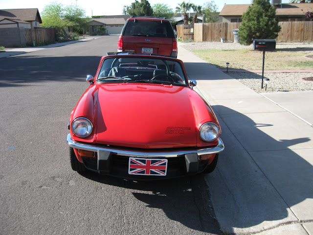

Here's some photos I took this morning:
Full Photogallery (41 pictures)
roofman
Purdy.
