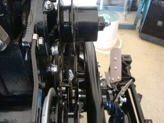

TR2/3/3A 1956 TR3 fan pulley alignment is off
mallard
The pulley alignment on my car is off by about 1/4". The pulley on the generator is out to far, or the waterpump pulley is to close. The generator mounting bracket can only go on one way so that's not it. The generator can only fit on the bracket one way so that can't be the problem. The generator does not have the correct date code for the year, could that be the problem? Date code 12-66 22700L C40. The water pump is an original pump rebuilt by East Coast Jag. The only fix I can see would be to shorten the generator mounting pedistal, but that moves it back even closer to the exhaust manifold. I know over the years many things get changed on these cars. Other than the pump, bracket or waterpump housing what else could be the problem?

Hi Mallard I own two tr3s and both of them are like that. I drew the same conclusion you did and at the end of the day, I left it. We had a similar discussion awhile back and a couple others noticed it also. Nice job on that engine ect. I am curious; the bracket on the generator bolt is that original ?

mallard
Well after further examination I saw that the generator pulley and the crank pulley align just fine. It's the water pump that is out of alignment I think.
Steve the arm did have a locking tab on it. I may have a picture of the original engine with it there. The one in the picture is one that I made in 15 minutes, Moss wants $7.50 for it. Part number 838-560. You have a good eye for originality.

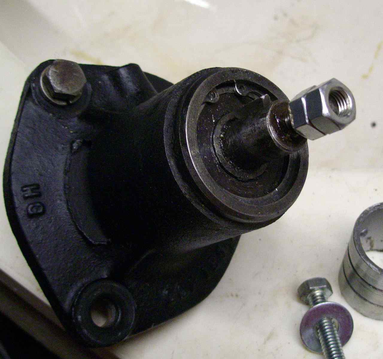

TR3driver
Great Pumpkin - R.I.P
Take a look at your pulley, you'll see that the slot (aka keyway) goes all the way through. That means it cannot be located fore/aft by the Woodruff key (the key only keeps it from turning).
Being somewhat curious myself, I pulled apart the pump from TS13571L (which is either original or a very old replacement). As you can see, the pulley was tight against the bearing race.
Suit yourself, of course, but I predict that, if you leave the pulley pushed forward on the shaft (meaning it is not clamped between the nut/washer and the bearing race), it will eventually come loose and ruin both pump and pulley. And the radiator if you aren't lucky.
BTW, there is some variation in how far the impeller protrudes:

Both my TRs are like that, here's a look at the TR3...
Yes Steve, you need that locking tab for the bracket bolt. I drove for years w/o it then somewhere on a 1000 mile trip the bolt fell out. Didn't even notice it until I was home -- dynamo worked fine just held by the lower mounts but that can't be good for it.
Like Keith -- I couldn'e see paying 7 bucks for something so simple, made on out of a fender washer I already had. Couple of minutes with the grinder was all it took.

I went and got all the measurements from the original pump and they are all the same as the rebuilt pump. I'm using the original pulley from my old water pump on the rebuilt pump. I don't see how unless the pump pulley is not correct. I will try to compare another pulley with mine and see if the area with key slot measures the same. I don't have an extra pulley so I will have to find one. Or can someone measure one for me. Mine measures 0.983". I did measure the gap between the generator pulley and fan and came up with 3.4mm not the 2mm that Viv mentioned. This could help the problem but would be far from solving it. To make the alignment perfect I need to pull the water pump pulley out 1/4"
Steve said he and others have had similar problems with this alignment and they just left it alone. I'm afraid this would not be good for the bearings in the pump and generator. Well it's time to go eat some Turkey and watch football.

Maybe I'm missing something, but it looks to me like there are enough threads leftover that you could insert a spacer between the pump & front bearing as I suggested before. You might need to use a center-lock nut or Loctite instead of a Nyloc, though.

In the picture the pulley is held on with a very thin washer and regular nut. The original set up was a thick washer and a nyloc nut. My concern with the spacer idea is that the pulley would not be making contact with the shaft on the end where the threads start. I was thinking that if I made a spacer that would fit tight over the threads and against the inside of the pulley it would eliminate any side pressure. I don't want the pulley to cut into the shaft, or the hole in the pulley to be ovaled out.
TexasKnucklehead
Randall, you often amaze me. I'm sure you're right and the picture certainly shows the pulley was against the race. I'm not sure it has to be, as the fit between the shaft and the pulley is very tight. -But (as you said) I'd hate to find out the hard way.
So, I must agree that Keith (Mallard) could employ a spacer between the pulley and the bearing and still have enough threads for a nut to hold. Mallard, I think you're thinking the spacer goes on the end of the shaft near the nut, but it doesn't. You need to pull the pulley completely off and install a spacer before the pulley goes back on. The spacer should rest against the bearing inner race at the bottom of he shaft. The little bit of pulley near the threads that will not have shaft touching inside, will not be an issue.
