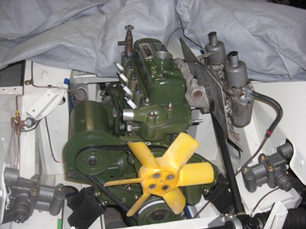

I second the suggestion to call David, he was very helpful to me in my 1275 engine build.
Scott in CA
