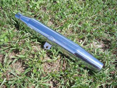

I went the Harley route with a Pacesetter header! I like the sound and the nice chromey part and it seems to breath nicely!

Are the Harley mufflers restrictive? I have some stock mufflers from a Sportster 1200. People THROW THEM AWAY at harley shops.
The Harley shop in my city sells them to the scrap yard, so you can buy a set for about 5 dollars.
It's a shame, since they're pretty nice mufflers. And they are brand spankin new.. The bike owners don't want em.
bugimike
They are not restrictive at all...built like a cherrybomb (only nicer!)!! And, yes as you say, all the Harley owners seem to opt for fancy, custom units, discarding these freely!!!! :banana: :thumbsup: :cheers:
PS: for those interested, inlet ID is 1 3/4"
