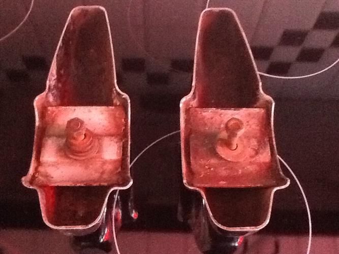

how does one differential a reproduction over rider from and an original? What are the differences between a 100-4. 100-6 and 3000 over rider? Pictures would help to visualize the differences. Thanks

I think these are overriders for 100, Flat top and no wave in the bumper;
The 3000 version has a W shape like the bumper itself
Most remakes have no flat in the top

So would you say the pics of the one I posted earlier is an original ?
BigGreen
For what I have found ... the chance is high

From the photos published here, I have see they are the same mounted on my MG TD 1952 that I have recently on hands
available from MOSS USA or UK -my opinion:_ good repro and good chrome work-
