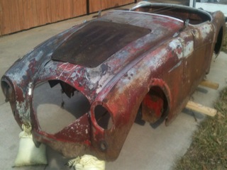

I just found a 100-4 that belonged to my father years ago, but not much of the car is left but the body and skeleton frame. It is missing the chassis, engine, seats, dash, windshield, and running gear. The guy who bought it from my dad cut the running gear and main frame out for a kit car build in the 60's and those parts are long gone. I just found the chassis.tiff on another sight and I am thinking about making a chassis out of scratch and finding a mga or mgb to use for the running gear and engine, but making the car look on the outside like an original 100-4 with a mga or b engine. If I can find original rusty running gear and engine to rebuild I would do that but I am not a rich guy, but i am very skilled in restoration work and can bring dogs that no one will waste time on back to life again.
QUESTION 1: is this a real bad idea to put a mga or b in this car or should I save the car for the next 10-20 years and try to restore it right? Problem with doing it right is I may never get it done that way unless I can find a dog of a parts car to restore the parts on.
QUESTION 2: does anyone have or know of an old rusty frame I can buy or have that I can use as an exact dimension for building my new one. I would like to find one someone is junking after buying a replacement chassis... I am skilled enough I can do my own concours chassis build using a old rusty frame for measurement and the blueprints.
QUESTION 3: does anyone know where I can find an original rusty running gear, engine, trans, springs that I can restore and put on my car?
I will try to post photos of my Healey as it is now... And I have restored and unrestored antique gas pumps, and candy machines that I can trade for parts. I also have an antique original walrus ivory tusk for trade for parts...

I have three MGA's and a BJ8. One of the nice things about the 100-4 is the performance which you will loose with an MG engine. That said it is very easy to find an MGB engine and you want preferably a 5 main engine made around 1967 if possible. The dimensions of the original chasis are easy to locate. If I were you I would build the chasis and body while looking for a good deal on a used restorable Healey drive train. Have a good day!
stevebn2bj7
I would not put in an MG engine. I think you will be very disappointed with the performance. The Healey engine was 2.4+ litres where the MG is what, 1.8 or so? Nowhere near the torque of the Austin engine. I would wait to find a Austin 4cyl, which will be expensive along with its transmission or go the V8 route. Since the car is already in process of that modification you are not destroying a good intact car. If you are concerned with value, a V8 conversion will be worth more than a MG conversion but neither will be worth the value of having an Austin engine. FWIW
HealeyRick
With how much of that car is missing, the cost to repair it even with a ton of sweat equity is going to be cost prohibitive. If I had the skills to build my own frame, I'd be looking at building a tube frame with a Mustang II type front end, american V8 power and rear axle and hanging the body on that. Kind of like a Cobra kit car.

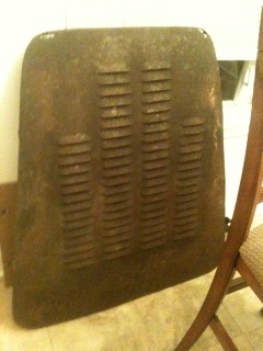

Body batch number is all I can find:
My dad bought this car new in Hawaii in 1955 and had the navy ship it back to Topeka when he left the navy intel office, he sold it for 850.00 in the late 60's. If it was not originally his I would not have bothered to buy it, but would be working on a model t armored car instead.
I will also post some photos of my other work that other restorers have refused, but I restored with no problems. This car should not be that big of a problem for me. I find it more fun to restore things like this because most people can not picture the finished product. The gas pump in the following photos was hit by cars on 3 sides, it took me 2 weeks to get it back to new specks inside and out.
