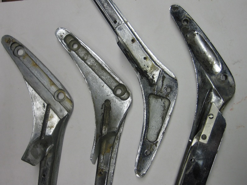

Here's a picture of four different sets that I've run across. Who knows, there may be more out there. :tennis:
The one on the right is the only one that takes the slide-on guide plate. The next one is probably the one that takes the "spacer, filler" plate mentioned above. There is a sort of evolution going on.

Yup. The one I dug out last night falls between the one on the far left in your photo, and the one next to it. Takes the filler plate, but the slot is finished so, in theory, it could slide off of the filler plate. As I recall, the plate was pretty well stuck to the paint, so that is actually the way I took it apart.
There were also some post-60K stanchions that were aluminum instead of chromed brass; I assume to reduce weight in racing classes where a full windscreen was required. But I hear they are too weak for everyday use and so there are very few left in circulation. One of our club members has the aluminum surround, but I think she has chrome stanchions.
