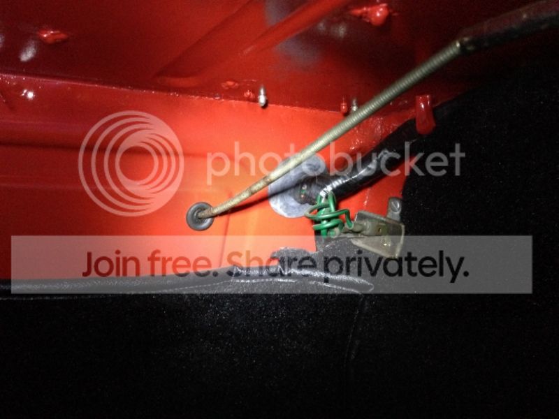

trrdster2000
Passenger foot well, up in the right corner. Many a foot in the autocross with passengers knocked it off.

Just looking at Jay's picture brings up a question in my mine. Why in the H... did they change the hood pull in the TR4A and TR6 to the other side and snake it around so much it will always be hard to pull and many have I seen with the plastic broken off????

Wayne,
The pull is in the same place on the TR4 and TR4A (passenger side). Did you mean just on the TR6?

Of course it is. Early in the morning for the brain to be at full speed. Thankls,

I always found it amusing that they abandoned the remote hood latch on the TR2, then apparently brought it back later at the market's insistence. Of course, having the hood open from the rear makes the latch a whole lot less critical!
